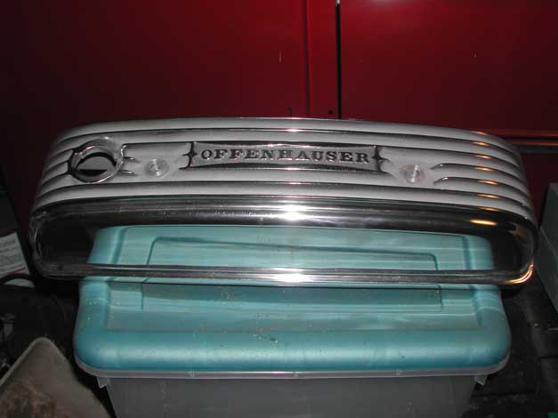

TR2/3/3A TR3 Valve Cover
Twosheds
OOOO! AAAAH!
Not mine. Delivered here for a friend.
Nice, though.

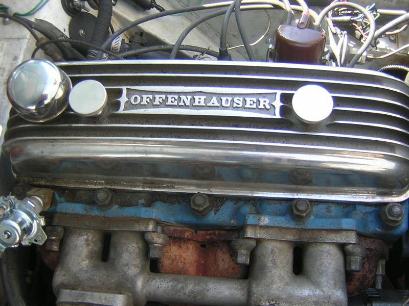

tinman58
I have one on my TR3. Looks great, All the old Motor Heads think it came off a ford 312! ??????
TR4nut
And one is going on mine. The finish on it is beautiful I think. I'm going to fab up some studs for it soon because the stock ones seems too short - haven't fitted it yet, but does it take a stock gasket? Would like to use Justin's silicone one if I can get away with it.
tinman58
Yes the stock gasket will work. I am using the silicone one and it works fine. All you have to do for the studs is to cut and weld two bolt (studs) to the right size. or use a die and cut new threads on a piece of round stock.
apbos
I've seen them with all the fins painted. I like the touch of red as it is an Offy color. I've got a spin-on Oil filter cover that I did the same way.

Twosheds
Twosheds
This one came with studs, oil cap, a cool sticker, but no gasket.
Don't know about the gasket. I'll ask the owner if he wants the silicone gasket or stock. Justin will know if his fits.
TR4nut
Ah, something tells me Macy's garage open for business! I talked with Mark about the cover a while back, and pointed him to an oil cap that fit pretty well - is he giving out an oil cap decal TR-style with it as well?
Twosheds
Twosheds
Nope, the sticker says Offenhauser Equipment.
Cap is a Mr. Gasket. It's kinda dome-shaped, so I don't know if a TR-style cap sticker would lie on it well.

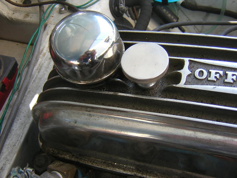

Moseso
And, this is what one looks like after a few thousand miles of driving the car, instead of sitting around polishing the car.
TR4nut
Moses-
I like the grime, gives the car the proper TR patina!
Do you know if thats a Mr Gasket cap? The one I bought is more squared off - it fits will but I think the od may be a little bigger and I'm worried about interference with the valve cover nuts.
Randy
Moseso
I don't remember the brand, Randy... It's the one that Exeter sent me when I bought the whole rig from them. (Had to make my own mounting studs.)
TR4nut
Thanks Moses-
Exeter must have been cutting corners when I bought mine - no cap came with it.
Randy
Moseso
No cap "came with" mine, either. They charged me an extra $8.95, or something, for it. It was a telephone order, so we talked about the need to have one -- stock cap doesn't fit, etc. -- so I asked him to send what he had that would fit.

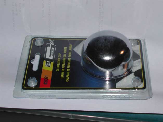

Twosheds
Twosheds
TR4nut said:
Moses-
Randy
Randy, Moseso's cap looks similar to the #2061 Mr. Gasket cap that Mark sent.
He sends acorn nuts instead of the cool knobs that Moseso has, though.
