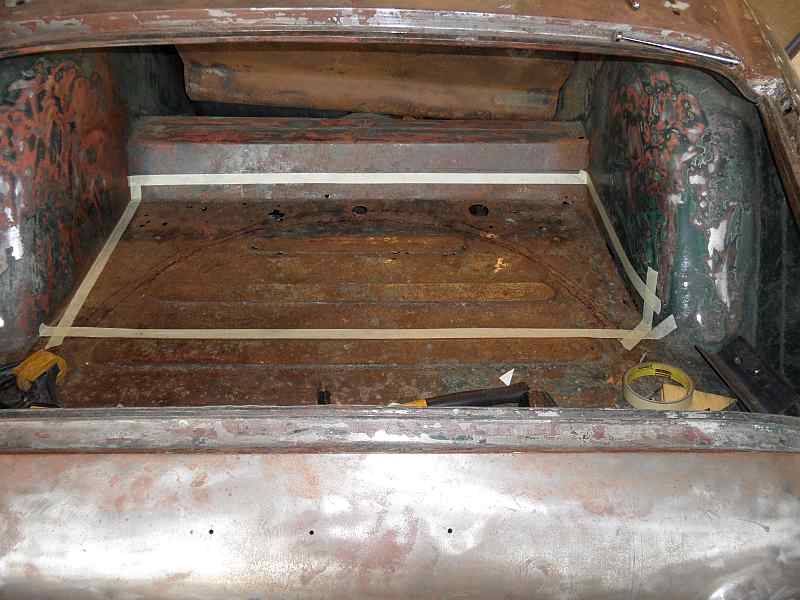

My car came with rubber glued to the bottom of the tank. If you look at this picture of my trunk, you can almost see the rust holes outline where the rubber sat on the floor. I'll be using felt this time around.

I used the felt originally, but it trapped water and started rust on the new boot floor pan. The next time, I used smaller pieces of foam. Better, but still rust when I removed the tank for cleaning last year.
I realized that nothing can prevent the water from collecting around whatever I put there. The solution is just to make sure the boot floor can't rust. I cleaned off the paint and put POR-15 on the area under the fuel tank, then roughed it up, primed it and painted over it.
I've got rubber strips there now.

TK thats what the rust looked like with my car and felt pads. I like the idea of the felt for the straps. The key is to have a Boot lid that does not leak. I'm not sure what I will go with.
