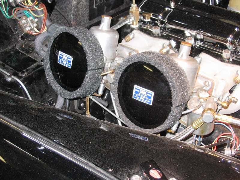

I had exactly the same problem with my 1958 TR3A on a 1550- mile trip from Montreal to VTR in Valley Forge PA and back. I put it down to the 10% ethanol that is in all gasoline in USA but I never had this before in Canada. I always buy my gas at Shell here in Canada and back then I assumed that Shell Canada had no ethanol. While in PA I removed the outlet pipe just at the exit of the fuel pump and the pump would pump like new.
I suggest you do this to check your pump before pulling it off the block.
But my float bowls would remain empty when I would re-connect tye outlet pipe from the pump. It would start like you if I filled the float bowls. After about an hour the problem would seem to disappear, so I would carry on till it happened again.
Randall Young suggest that I change the 50-year old feed hose as the ethanol might be affecting the inside of the old rubber. I have the banjo fillings on mine so I took it to a hydraulic hose shop and they made me a new one. I put it on in 2008 and started to add 4 oz of Marvel Mystery Oil to every tankful of gas.
Since then I've had no issues, even when I filled up in Vermont at a Shell pump where there was a notice that the gasoline at this pump contained 10% ethanol.
