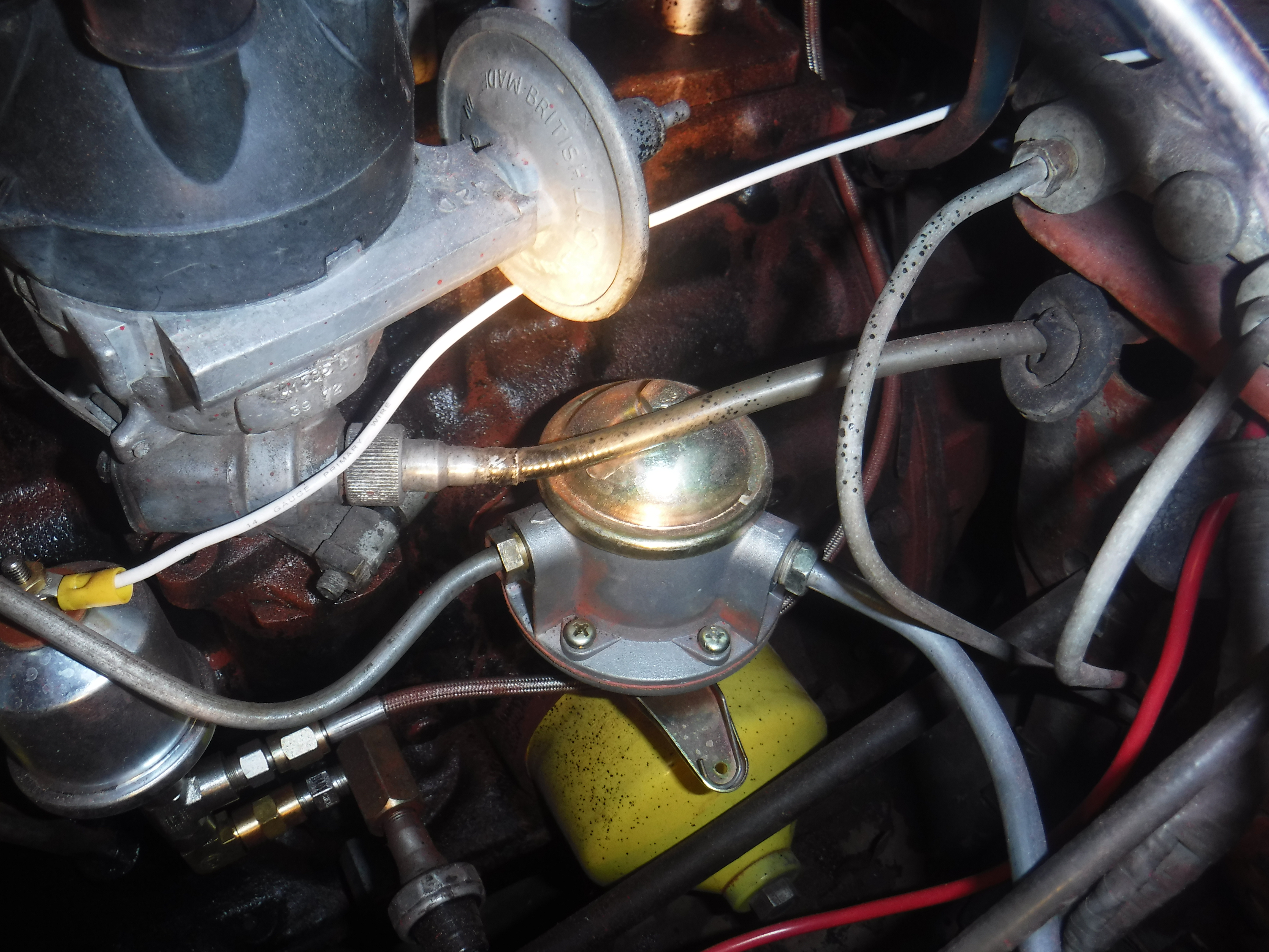

TuffTR250
I think this is what you are looking for. Note that the outlet fitting is a special longer part. Here is discussion from thread:
"I talked to Albert at TRF. Here are the TRF p/n's. He said they buy the compression sleeves from a reliable source, not general hardware store, but did not know the length of them.
>5/16" tube nut is 60142, and 5/16" compression sleeve is TL8
>1/4" tube nut is 60176, and 1/4" compression sleeve is 102729
He said both the tube nut and compression sleeves are the same p/n's for TR3, TR4, TR250, and TR6.
Bob"
p.s. It is by far a good idea to get the tube nuts from TRF and NOT a local FLAPS. The FLAPS parts don't work for the 1/4 inch fitting.
Here is the full BCF thread. Best to go all the way through it to find the correct information:
Good luck!
Bob

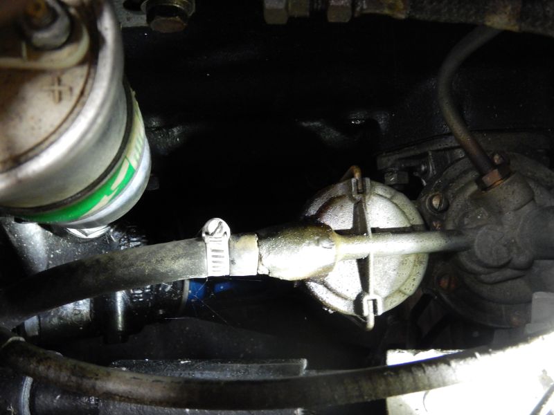

Madflyer
Bob is right I have fixed a number a TR6's do to wrong nut to sleeve If the surface of the nut touches the pump then it is to short and does seal with sleeve. I have seen tape copper washers trying to fix a leak it is just a fire waiting to happen. This is on my GT6 but same on the TR6 and TR4
