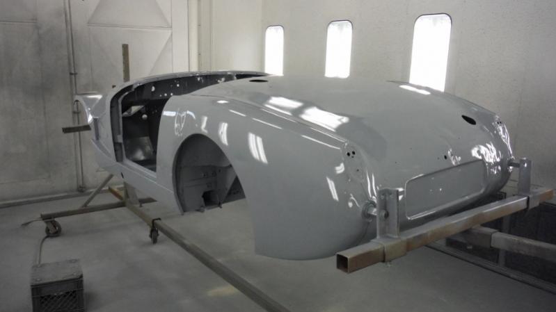

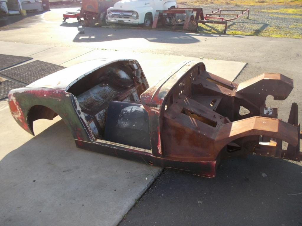

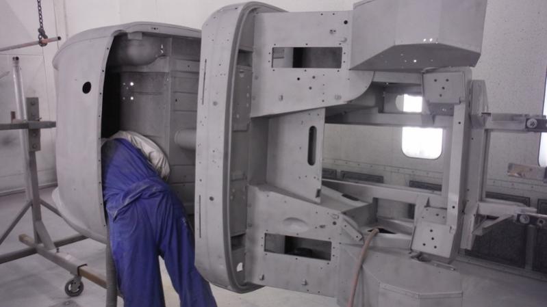

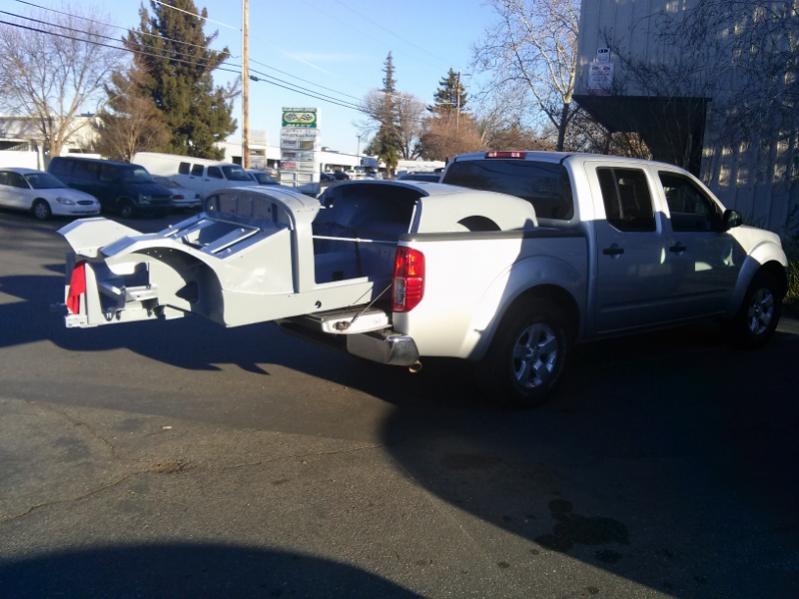

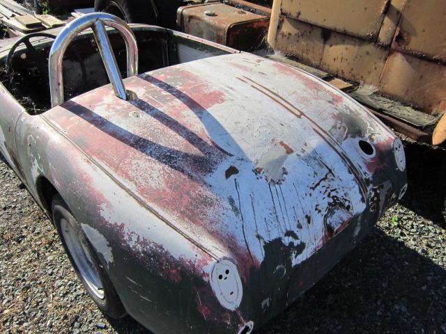

I think I am on year 5 of owning my bugeye now, and its been quite fun, and of course frustrating. I bought my car from pics from a fellow some 9 hours away, and had it hauled down by someone who happened to be moving from here near the seller. About 2 years after owning it, I got sick of the panels not lining up and talked to a buddy who had a body shop. He put it on a rack and told me the car was quite twisted, and would take a lot of cutting of panels and pulling it back straight, then welding things back up to make it right. So being a stubborn person, I went and bought a roller bugeye. It's a retired racer from the 70's, and had been sitting in a barn since. It had surface rust, but no cancer. My goal has been to fix up that body and swap parts. Today I finally got the bugeye from a friends resto shop from being abrasive blasted and primed and got to see what had been under the paint. My heart sunk and right then and there I almost gave up. But its in the bed of the truck and I am thinking of projects I've seen on here and what amazing work has been done to save these cars. I am going to try and stick with the project, but the shell is much rougher than thought, though very little cancer was found which was great. The only welding needed are one full floor pan and a spot of another. Pillars, rocker, etc are all clean.
Anyhow, just thought I'd share some pics of what I've been doing, and what I am getting into. I included a pic of the color I think I am going with, Mexico Blue factory on Porsches. And did you know a bugeye fits in a shortbed Nissan Frontier?? Anyhow, I may be in need some emotional support, therapy, and beer in the very near future.

As you mentioned it appears quite rust free. That's always what scared me. Being an old race car I think you would have to expect plenty of dents and to me it looks like a great project. You will need a little practice at shrinking metal but I would think you could get it to just a thin skin of bondo without much trouble. My BE had a hole cut underneath where the license plate would mount so that the PO could get behind the panels with a body dolly. I sealed it up with and inner and outer sheet of steel and a good bead of silicone sealer.

Anyhow, what you cannot see in the pic is the area where the wipers attach about 20 holes drilled in it for who knows what reason, the rear deck looks like someone layed on it and popped it in, then took a ball peen to knock it out, one fender that is pretty bent and may need to be replaced, 2 floor pans rusted, one good dent in each quarter, the rear license area knock in then beat back out very roughly, and random holes drilled all over that make me scratch my head and ask "why?"

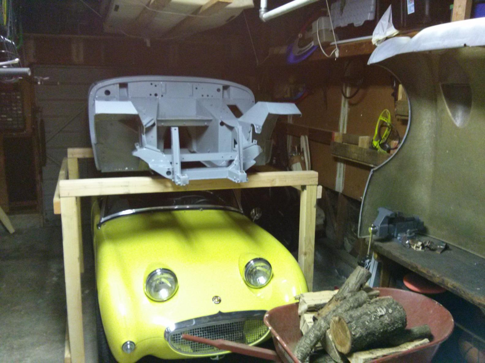

Thanks guys, appreciate the support. A buddy was just over with a few others to get it out of the truck....amazing what a beer bribe will do.....and he can weld pretty well and is will to help. I think the best way to do it is do an inventory of the problem areas, break it down to little areas to complete, and go from there. In the mean time, I'll keep working on my bent up car, restoring bits so they can be swapped over when the time comes.
Here's a pic of the garage with 2 bugeyes. Kinda cramped :smile:
