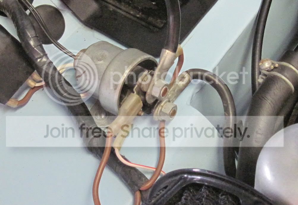

Here is a photo of one of Don's cars.
TR3driver
Great Pumpkin - R.I.P

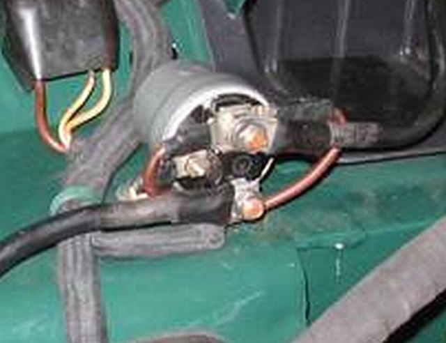

Here's another one, where you can see what I was talking about. The sleeve covers the wire/terminal joint, but not the solenoid terminal.

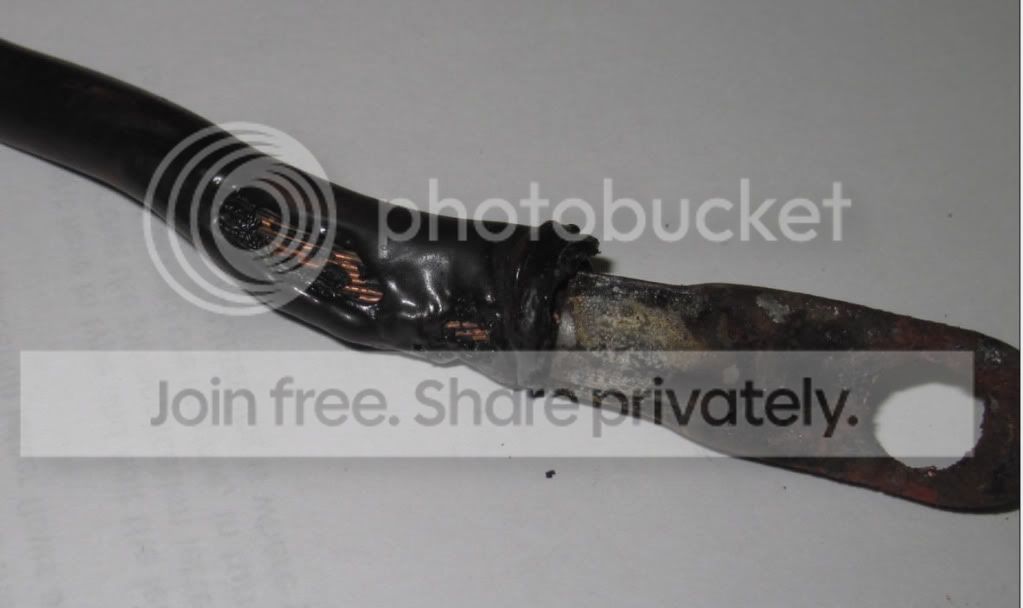

Here is another solenoid shot. The reason I have the photos is because of the second photo!! This end was at the starter. I have since replaced this cable with a black pvc coated 4 awg wire.
Al
