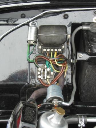

Here is the original one that is still on my 1958 TR3A.

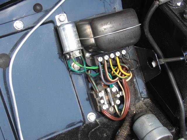

The body on my original starter solenoid is made of a casting of white metal or possibly cast aluminium with a thick heavy look to the wall or barrel part as well as the "feet". I believe the newer repro ones have the barrel made out of pressed sheet-steel which is then white zinc plated. The repros might have a push button whick is covered with a domed black rubber "seal" but some repro units come without the rear button to start the engine from the engine compartment.
The sheet-metal repro units have the feet where it is secured to the firewall about 1/16" thick whereas my original one has cast feet almost 1/4" high.
