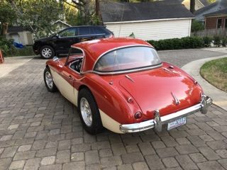

recently purchased bn6 just arrived yesterday. a bit of sorting to do but i am looking for advice or suggestions on how to replace a rather cloudy rear window screen and gasket. any help or advice is appreciated. i will probably purchase the parts from nical engineering unless the parts are available stateside.

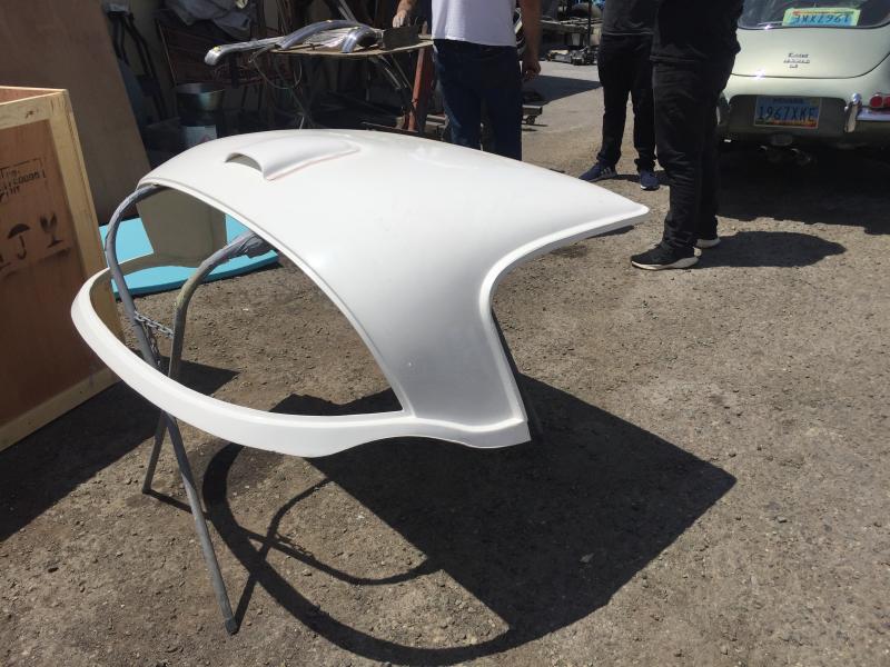

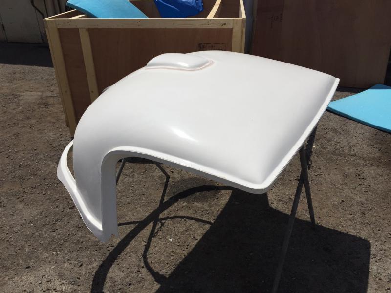

Here is the link to Lin’s article. I will be referring to this when installing the rear window in my Pete Farmer Works Type Hardtop on my BN1. Although this does not use the same rear window seal as the factory hardtops for the 100/6 and 3000s there are sure to be some useful tips.
http://www.healey6.com/Technical/LHRose Hardtop Restoration.pdf

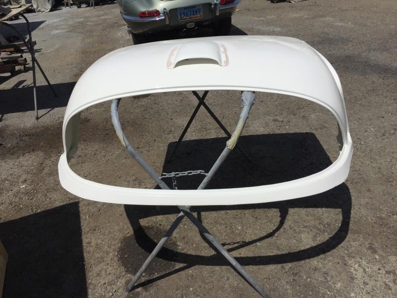

For those of you not familiar with the Pete Farmer hardtops, this is the works style hardtop with optional scoop for BN1/BN2....

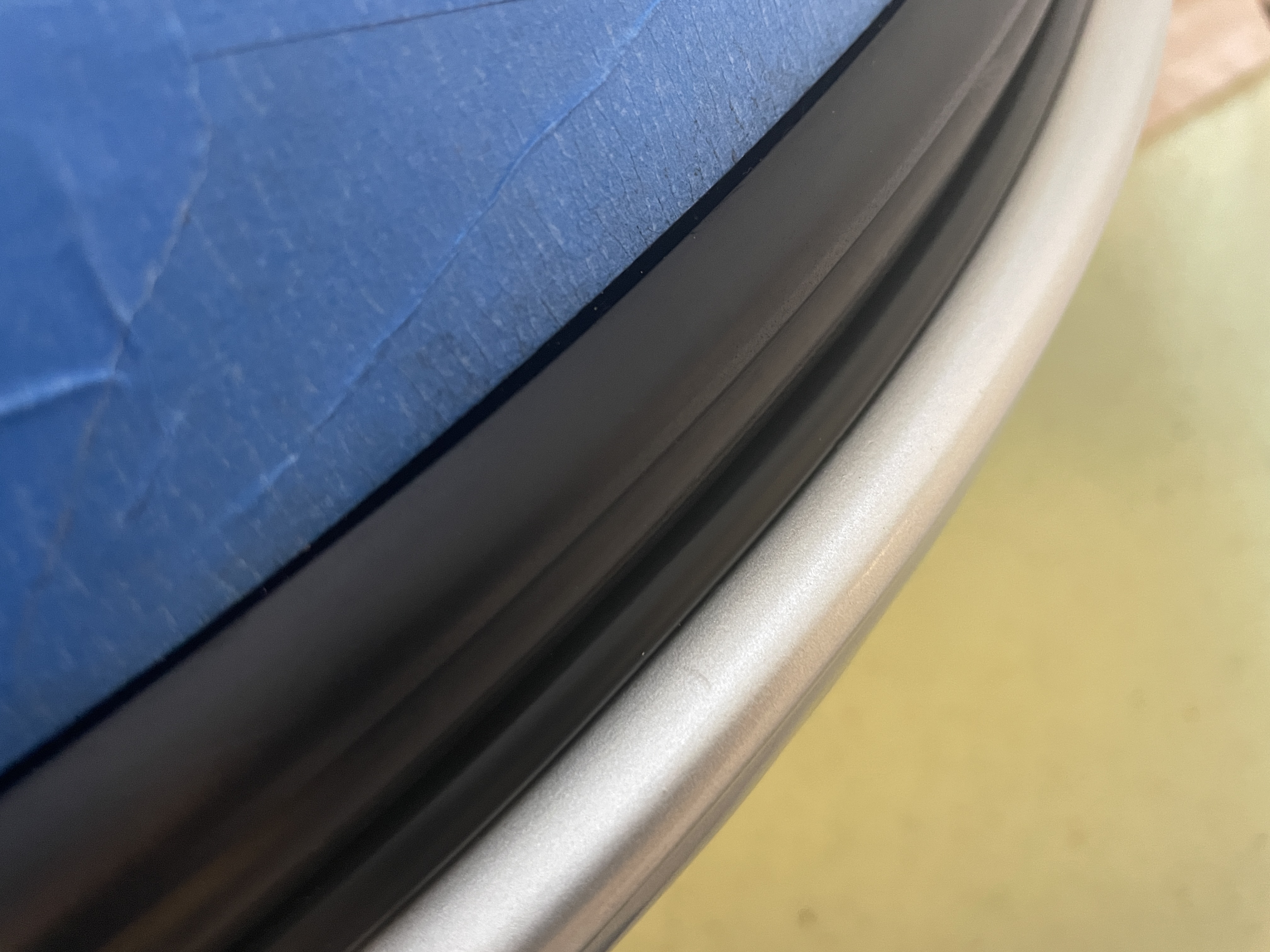

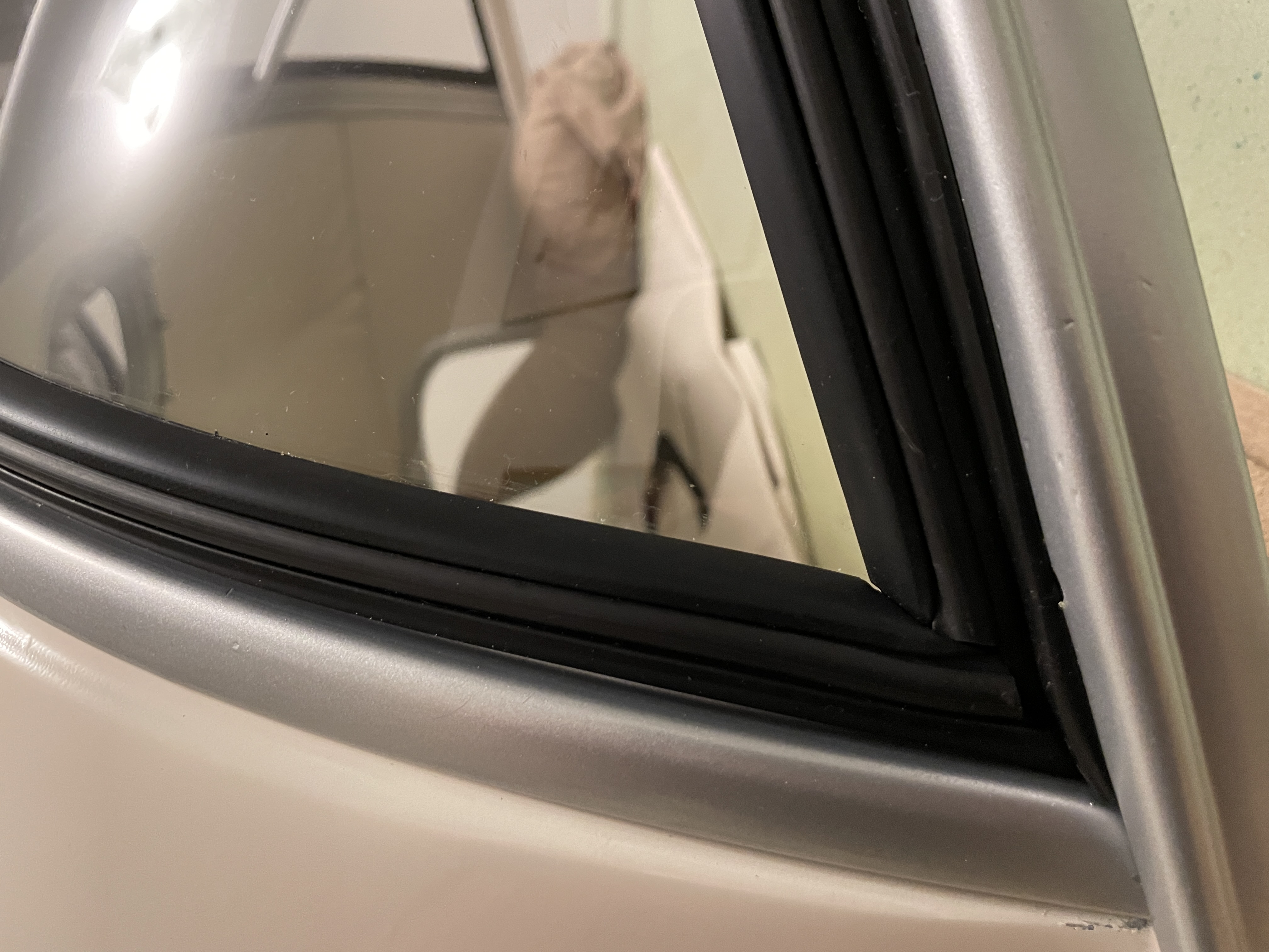

So here’s my fix for the seal issue .
Im going to glue a length of 1/4” O ring cord into the gap that the seal from Cape leaves and then run two fine beads of silicone to make the seal between the Oring and the seal and the Oring and the Cantrail

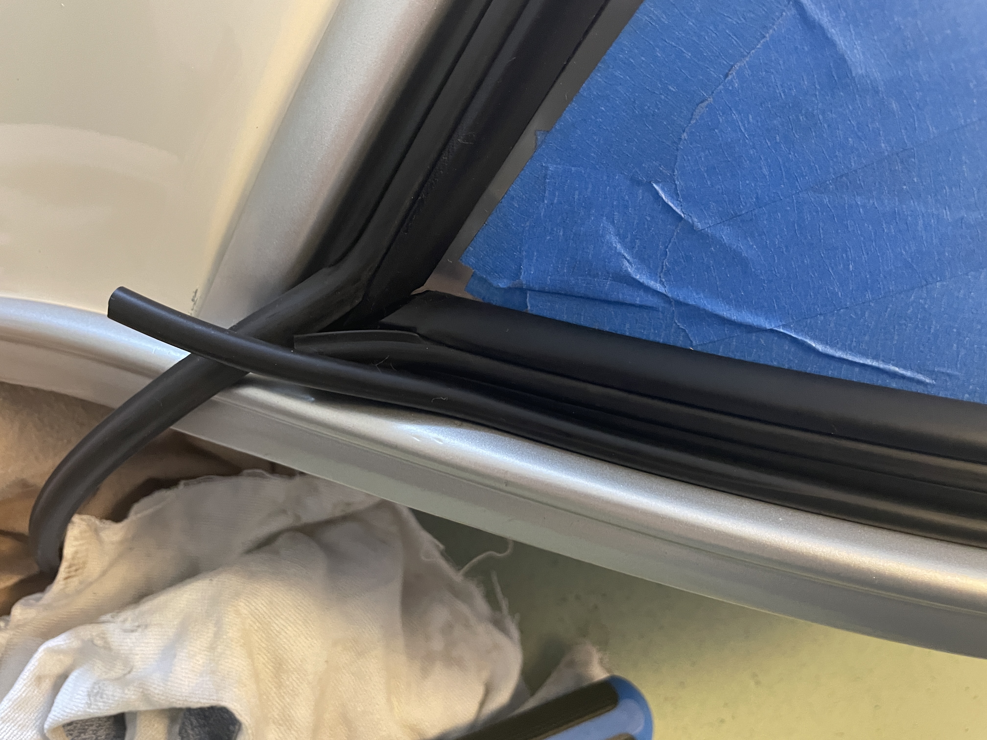

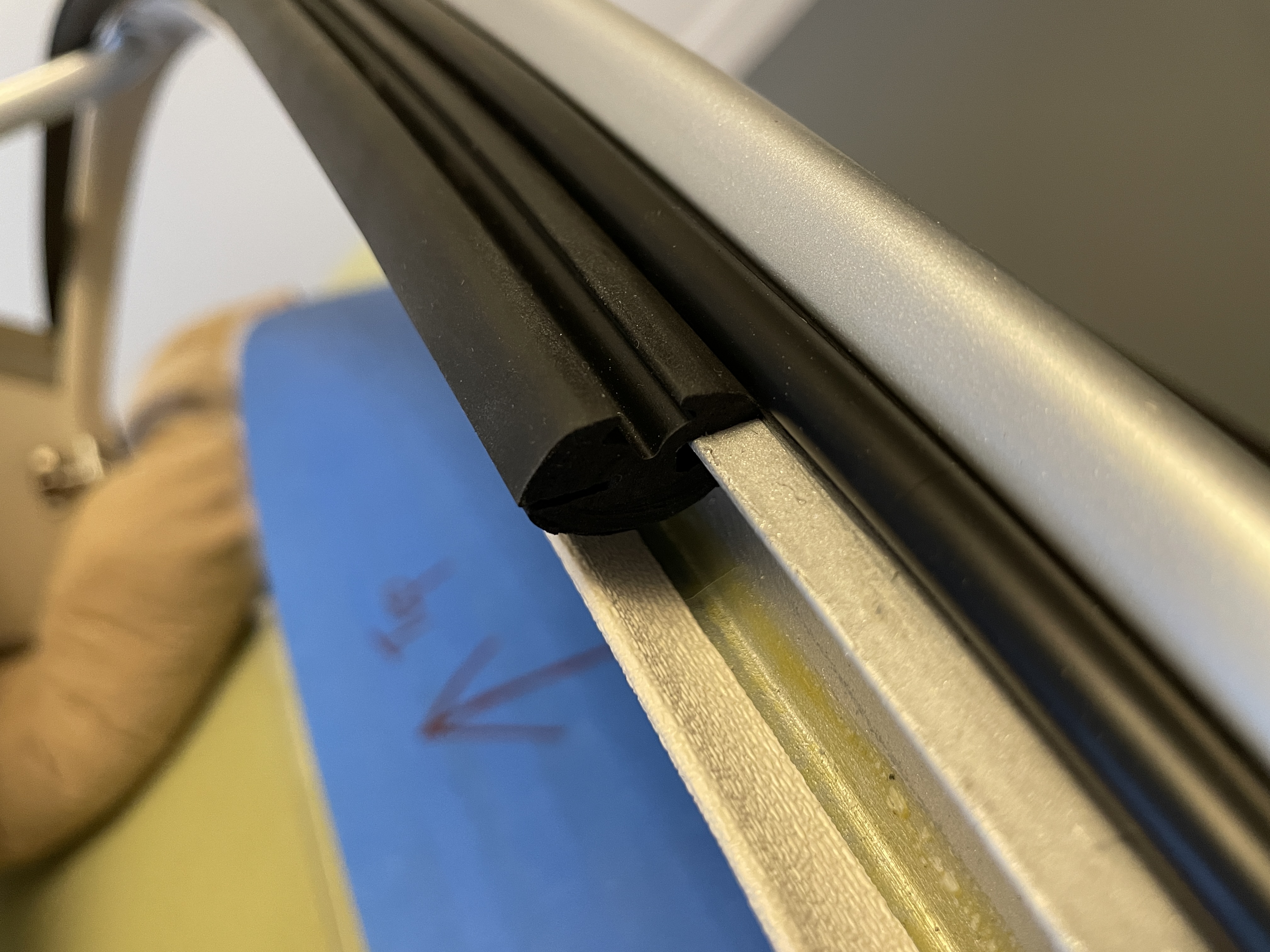

Healey Nut

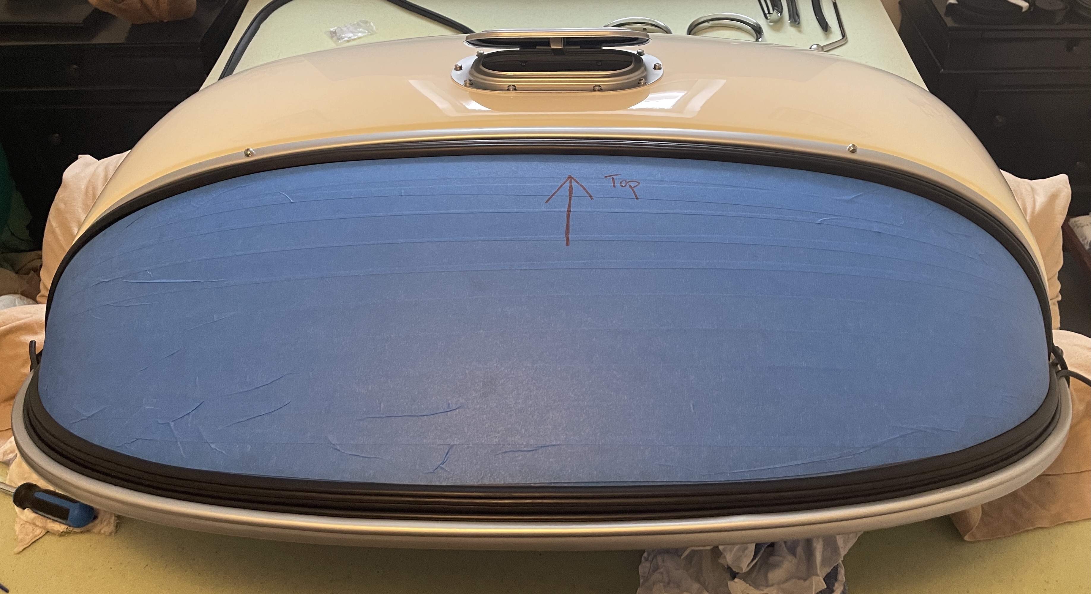

Well it’s in , pretty pleased with that .
I compared the old window (original I think) to the new one they were very close match . Installed it with just the seals in place no retainer spline . Didn’t like it thought it didn’t fit wasn’t going to work . Gaps at the bottom pointed corners .
Pulled it all out try again , seemed to be better no corner gaps . Roughly installed the splines using the special tool from Cape and some silicone spray as lube (Jig-a-loo) worked a treat . The splines helped to “set the position” of everything and I’m quite happy with it .
I have rough pressed in my O-ring section to fill the gap .
Once my fingers have had a rest from all the pushing and fiddling I will dress all the loose ends of seals and seal the O-ring section into place .
The grand finale will be to remove all my blue tape to view the finished product .
By the time I’m all done it will probably add up to a 5hr job to do the window alone but for a semi retired amateur I’m good with that

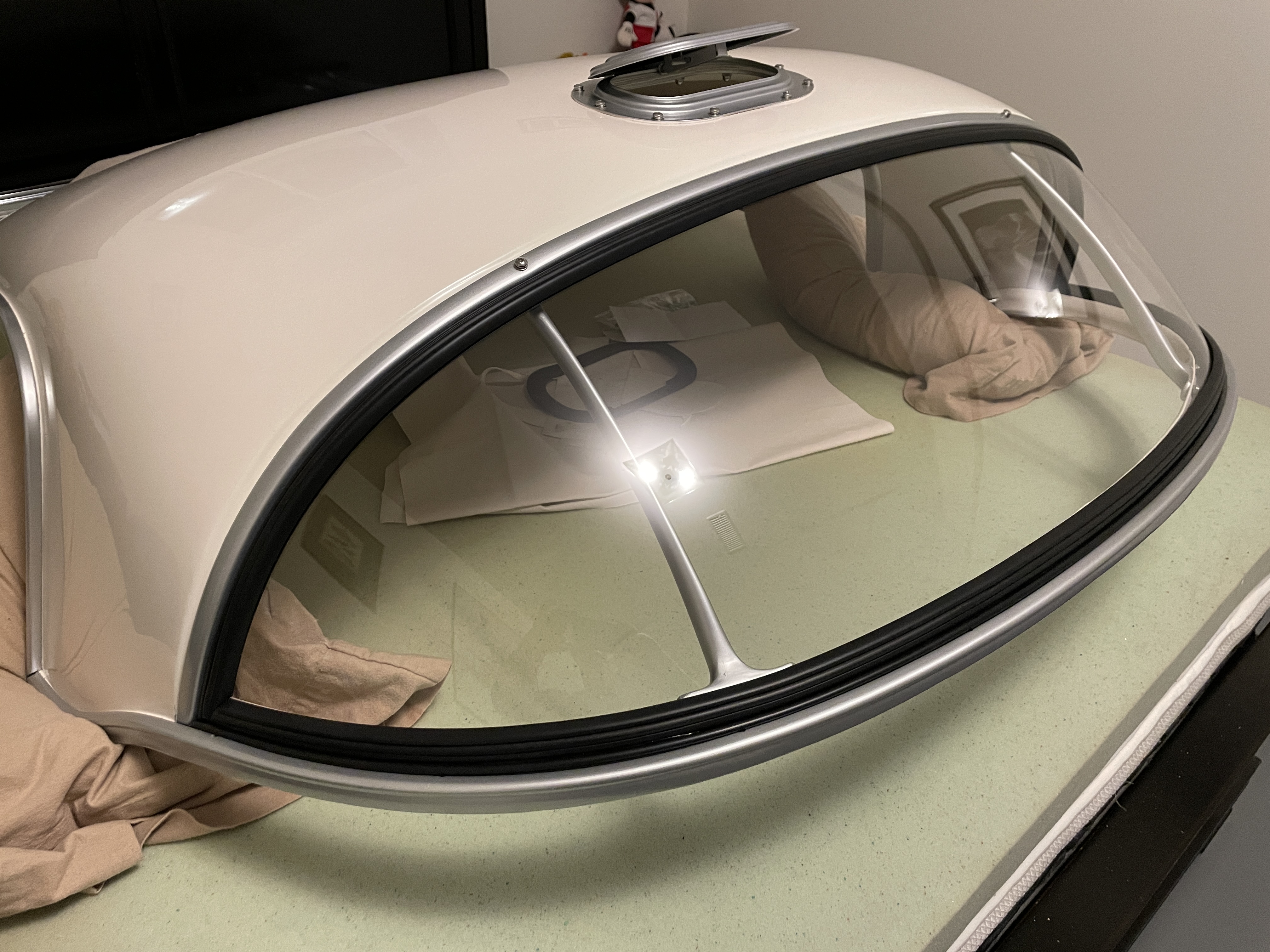

Healey Nut

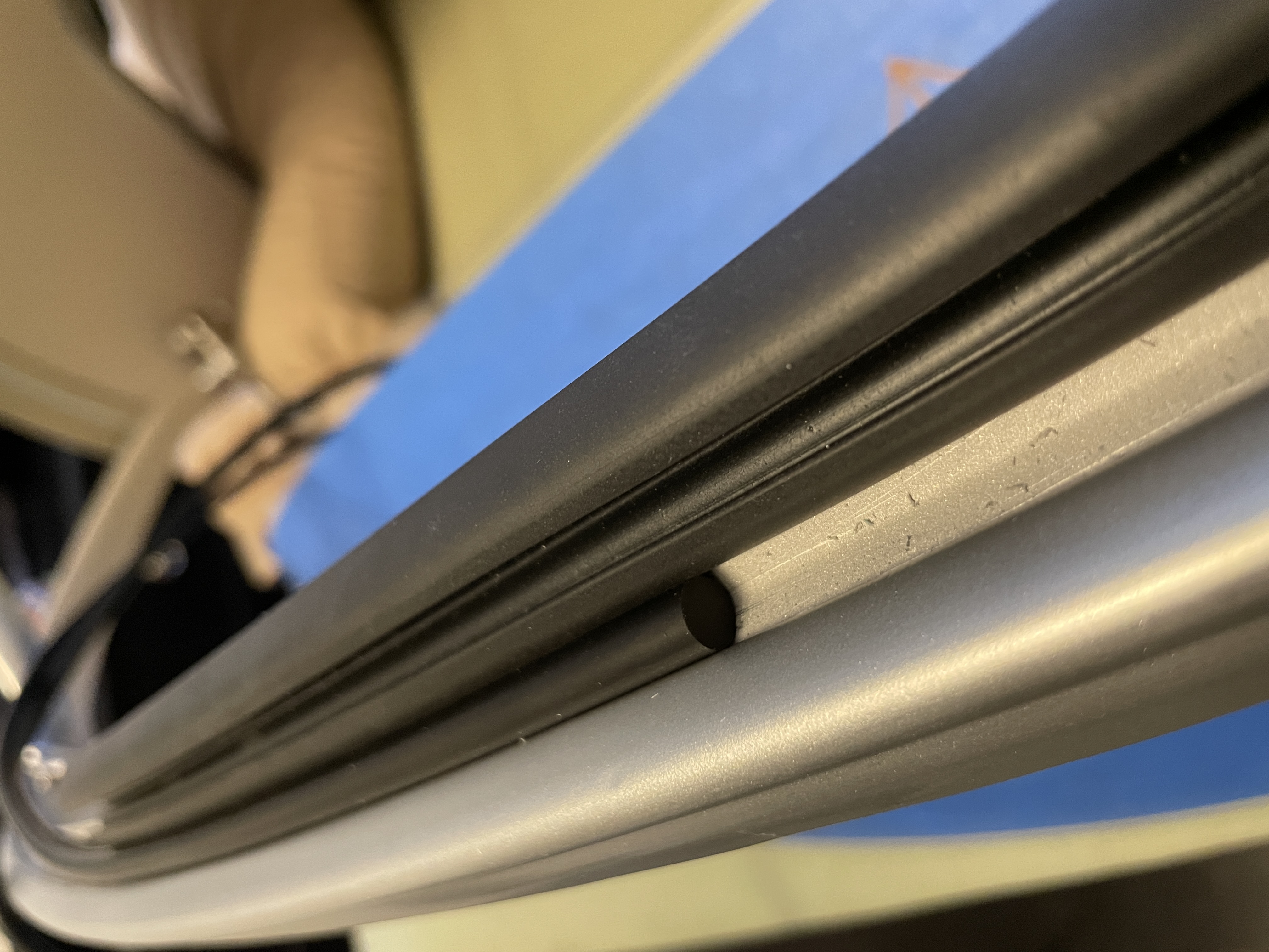

So here we are 99%done .
I did end up removing the window and reinstalling it several times . I decided to improve the fit as the seal was bulging at the top left . I taped the edge with blue tape then black markered the edge where I wanted to remove material off the window . I them used a palm sander and a coarse rasp to remove the window material using my black edge mark as a guide . It took several attempts as you only want to remove small amounts of material as you can’t put it back . I removed maybe a 32” at a time and refitted the window and splines to check fit .
The more I did it the better I got , had it down to a 15min window install by the time I was done .
Once you keep doing it it gets easier as you know how to manipulate the seals and window to tease it into place . Having a plastic non scratching trim tool and the correct spline installation tool is key . The Jig-a-loo works great for lubrication but only a small amount as too much makes a mess and makes things so slippery the window wants to pop out of the seals .
I have siliconed my add on filler O-ring into place and once that has set I will run the two fine sealant lines as a finisher .
Quite pleased with myself about this . Never done a hardtop before .
Just the perimeter seals and windlacing left once I finish the rear silicone finish lines .
