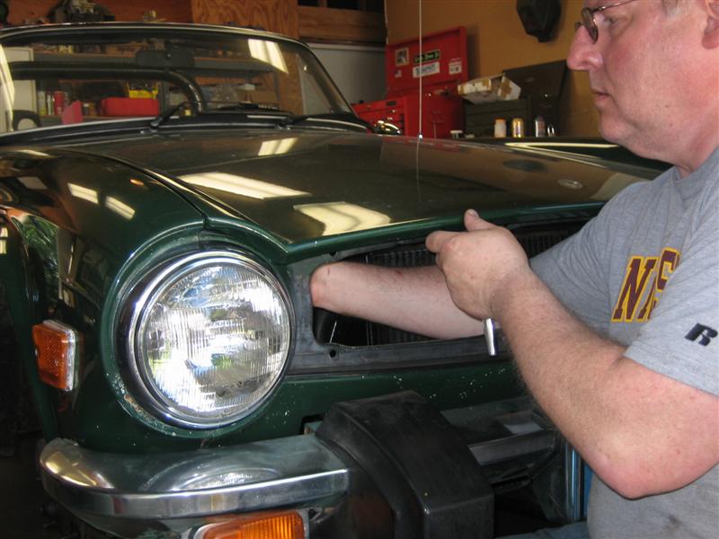

It has been a long time, nearly 50 years, since I had a TR4 but I did find this an easy way to do the TR6.
