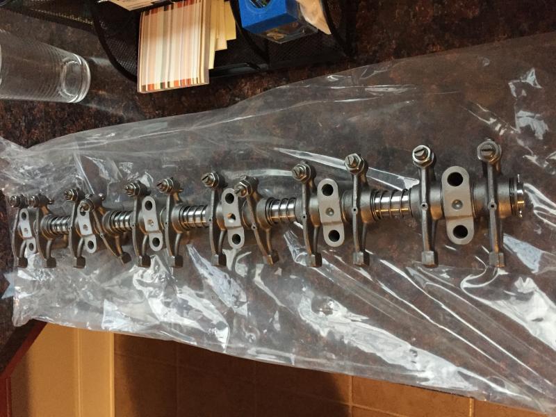

my assembly showed up this afternoon. hopefully all i need to get my car fired up. hasn't run in over 15 years so this will be fun... well i hope anyway.
Not sure this is ok on the forum, so this can be cut if need be.
but i wanted to say something about Rocker Arms Unlimited. (used to be Rocker Arm Specialists i believe) they were nice guys to work with and it looks like they did a nice job. they had a little issue with some shafts they got in so my arms were not done when they said. but to help out, they sent them to me 2nd day and paid that difference. i thought that was a nice gesture. not everything is in their control. but helping out is what seperates the good companies. i hope the business works out for them.

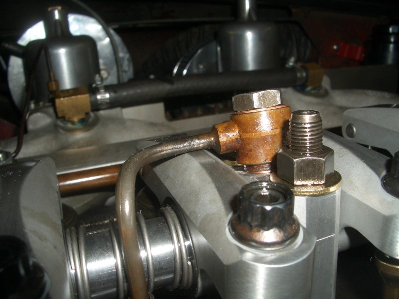

I've been very satisfied for almost 10 years with my 1.6 ratio aluminum rockers from the former Rocker Arm Specialists.
Note the small clearance issue I had with my oil pipe - added at least one (maybe two) extra copper washers.
Be sure to start the banjo bolt by hand with everything loose - it's easy to strip.

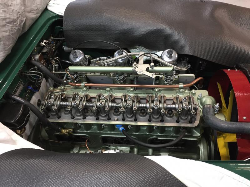

got my assembly installed today. i was able to rotate the crank by using the alternator and pushing down on the belt at the same time. my additional cooling shroud proved to be a PIA. i ended up draining some coolant back out and removing the top radiator hose so i could get some turn on the wrench. my addition blocks any straight on approach. but i was able to muttle thru it and get the valve adjustment done. just could only turn it a little at a time.
the banjo bolt for the oil line was interesting. i was very careful after reading so many posts about stripping it. i started it by hand without the line or anything the first time to get a feel for the angle. i don't feel like the bolt is straight up but tilted a little. anyway i could run it on up rather easily by hand. but it would not pull down enough to pull the line up tight. you could screw it in to a point and then it just seemed to stop. and get very tight. i did not want to strip it so i ended up using two crush washers below the line and two above it so it would pull up tight. that worked out fine for me. not sure why it does not want to go in all the way but it wasn't happening. i think it will work fine though the way it is.

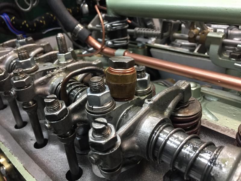

Does the spigot on the bottom of the bolt line up correctly__and centered__with the hole in the rockershaft?

Randy, I had not thought of putting in an insert when the threads go bad. Thanks for posting that. I sure wish someone made a flex line for that oil line. I have Roller rockers also from Rocker Arm Specialists and fitting that oil line was a pain.

Randy, that could be the issue. i will pull it back out and check for the hole. maybe the shaft got rotated or was not lined up to begin with? it definitely is bottoming out.
You can see in the last picture I was placing that bolt before the rockershaft was seated/torqued and valves set.
Even if you backed off all the rockerarm adjusters, that shaft may still be reluctant to be clocked, allowing the bolt to seat properly.
The full function of the upper-end oiling system depends on oil flowing up through the fitting** in the head, then through the tube/Banjo-Bolt and into the center of the rockershaft. From there it feeds the rocker bushes, hollow ball-ended rocker adjusters and finally, directs a squirt of oil to lube/cool the valve-stem tips where the rocker imparts a sliding downward push.

Randy,
it was just off enough to catch the end of the bolt. i had it lined up but then i did not leave the bolt in as i put in the assembly. just missed that step in the manual. i start to get excited when i am getting close to the firing.
it is fine now and goes all the way in. so started the countdown to the first firing.... another thread.
