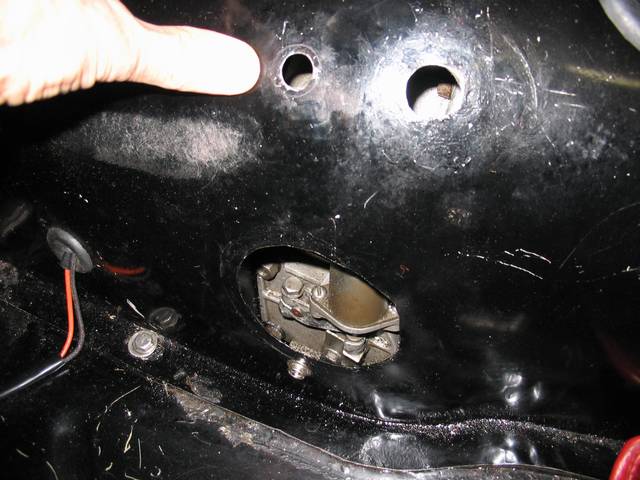

How does the wiring harness get from the gearbox to the dash? I've never had the tunnel on this car and the tunnel is in tough shape.Sometimes I think this car had 3 inches of water on the floors for years.
Don Elliott
The cables from the top of the gearbox and for the solenoid come through the steel wall of the tunnel near your heel for the gas pedal. It's the grommet closest to the left of the photo. The other holes are for access to the solenoid from the top. Two holes up high for a very long screwdriver and the large hole to see what your doing and to replace the solenoid. This large hole is filled with a rubber plug also used in the floor pans for the floor jack.

Don is correct, as usual. But I don't like having the wires through the side of the tunnel like that, so mine run up the firewall inside the engine compartment and through the grommet visible to the left in Don's second photo above. The grommet in the tunnel is replaced with a plain plug.
Also worth noting, perhaps, that none of the published wiring diagrams match the original wires on TS39781LO. The diagrams show a wire from the isolator switches directly to the dash operating switch, but TS39781LO had the wire from the isolator switches to one side of the relay coil, then the other side of the relay coil to the dash switch. Function is the same, but there is one less wire from the relay to the dash.
I considered adding holes as Don has done; but in all the years I've driven an A-type, I've only had two solenoid failures. And I prefer to avoid the "swiss cheese effect" if possible.

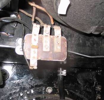

Well this like many other TR trivial details is subject to controversy or at least discussion. :smile: But, yes there is evidence that the side of the relay with three terminals points down, and not up as shown above. Here is an earlier version of my OD relay mounted like Don's car with comments from John Warfield, president of TRA.
<span style="font-style: italic">
Tags,check and see if your relay isn't mounted upside down...while the illustration in the Laycock handbook provided with early cars shows the 'three terminal side' mounted up, it's mounted in a saloon (likely a Vanguard). The TR2/3A Operations Manual has a section with a diagram/drawing that shows it with the 'three side' down. Not worthy of concours deduction at any rate but since we are all striving for perfection and it looks like you are getting close...:smile: J. Warfield</span>
Here's a clip from the Triumph Parts Manual which also indicates the single terminal pointing up.
I have since changed the mounting of my relay.

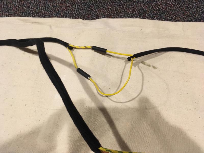

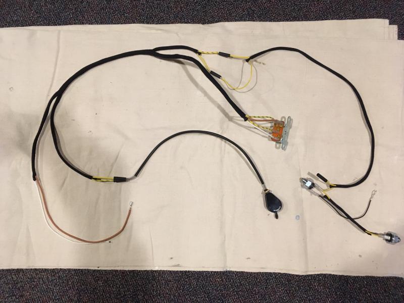

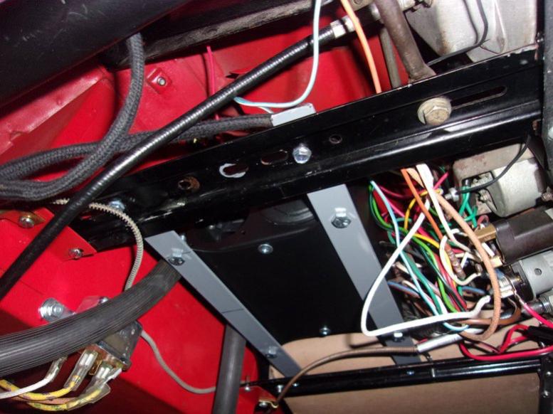

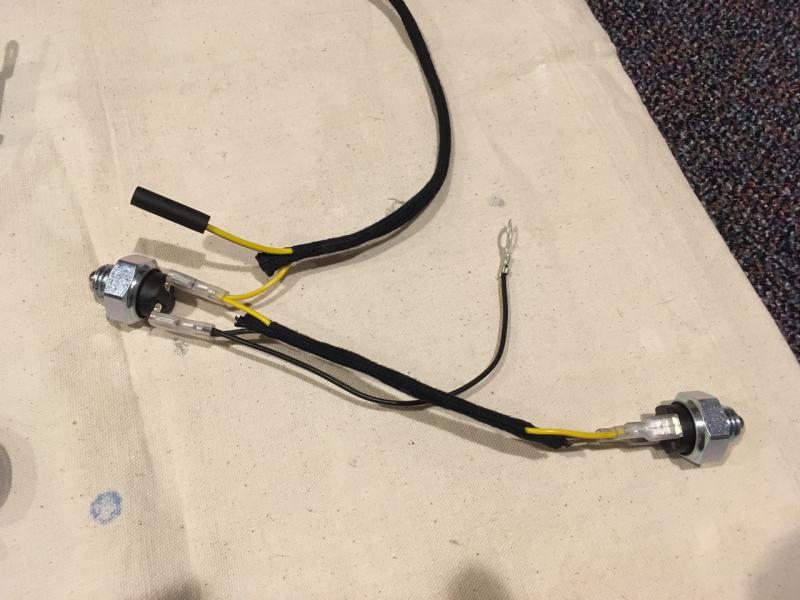

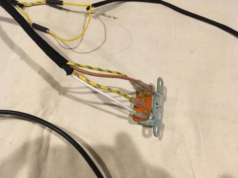

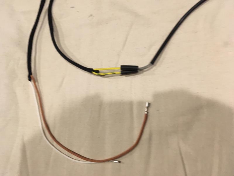

Here are photos showing the harness for my 1957 TR3. I laid them out to see how everything went together. One is the overall layout, the others are close-ups. You can see the wires for the OD dash switch. If you're asking how they were "run" behind the dash, it was "up and out of the way" from the relay, which is mounted on the lower left corner of the battery box (as seen from inside the car).

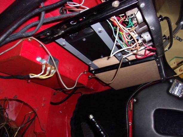

Yes, Steve, the wires out of the OD dash switch are gray, no polarity. Attached is a photo of underneath the dash showing the relay and the wires out of it, which go to the gearbox top under the carpet and a grommeted hole on the left (driver's) side of the tunnel, with the others going up to the OD dash switch and the white and brown wires going to the ignition switch and the ammeter, IIRC. As my car is still with Macy's Garage, I can't check to see the routing, nor verify the presence or absence of clips for the wires.
