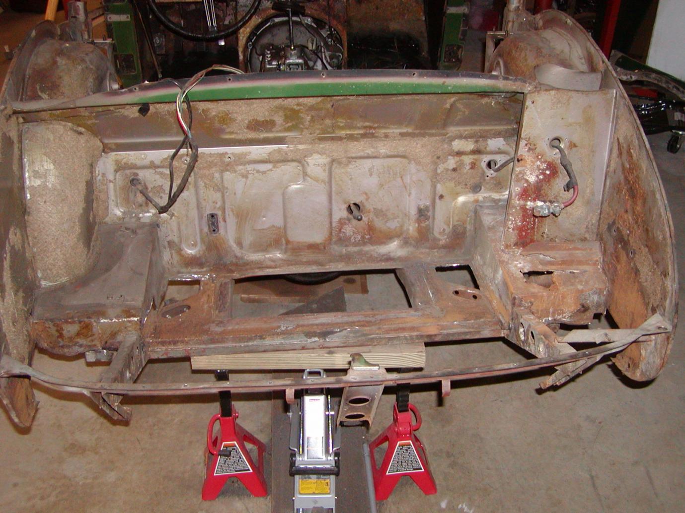

I know the wiring harness to the back end of the Healey passes from the bottom of the car through the bulkhead into the boot, but I don't know exactly where. I have a new bulkhead panel without the hole for the wiring harness. I'm pretty sure it goes into the boot on the left hand side (facing rear of the car). Can anyone post a close up picture of where the hole is so that I can approximate the correct location? My car is a BJ7 if that makes any difference. Thanks, Griz

Does this help , this is my 64 BJ8 . wiring can be seen coming through the heel board top left .

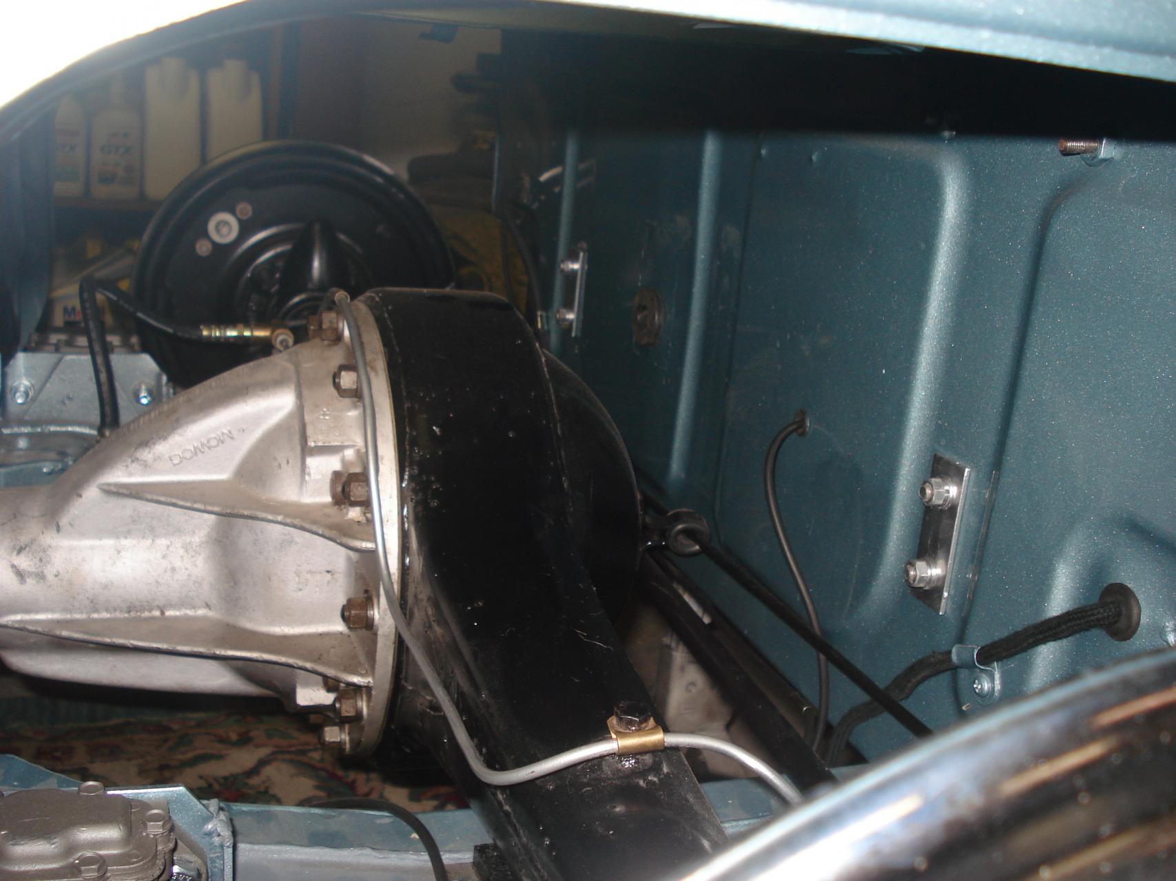

Here is an axle side view. Just remember that once the gas tank is in and the armorcord is in place the wiring should not be visible.

All good, useful pictures for me...thanks all. One more question, in HealeyBlue's picture, the smaller black wire is the gas tank sending unit wire I presume? Griz
