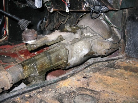

Hello:
Started my install of seat belts on my 250 today, since it's raining Again! (19" May-June).
Anyway started with pulling the seats & vacuming the crud on the floors, so while I was at it though I'd clean the floors & throw a coat of rustoleum for prventive maintenance.
So I pulled off the tranny cover, what's left of it to check the level I see the oil stain in the attached photo.
Looks like fom top cover near reverse light switch.
Opinion please as what needs to be replaced. Could be 30 yrs of leak as I have never been under the cover.
Don't want to let shipwrights disease take over!
Thanks.
p.s. guess what color the car was orig, green...

Looks like oil/grease that has dripped down from the shifter.
Maybe, years ago, somebody was having trouble shifting, so they dumped a bunch of grease into the shifter to loosen it up? That is what is left of that idea.

You call that a leak?......
A leak is when people following you spin off into the weeds.
What ya got there is patina /ubbthreads/images/graemlins/grin.gif
Brosky
A "minor" British car leak is when the guy following you needs his wipers on a sunny day.
