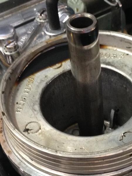

3. I found oil in the rear carburetor, why is it there (photo attached showing how much)

I'm not sure about a BJ8, but on my BT7 the air cleaner for the rear carb is connected to the vent on top the valve cover. If you have a lot of oil coming out of the rockers, you will get oil sprayed up into that vent and into the rear air cleaner. Start the engine and look through the oil filler cap on top the valve cover. Oil should just seep out of the top of the rockers. If it's squirting, your rocker shaft is worn.

I agree with Keith that the oil is coming from the valve cover vent and how to check it.

Oil in the rear carburettor comes from the breather, which means crankcase pressure caused by blowby from worn rings and Pistons.

I agree, oil is coming from the breather, how else could it get into the rear carb, right?

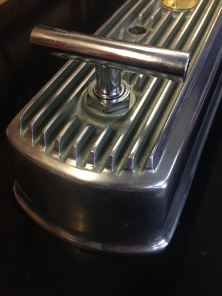

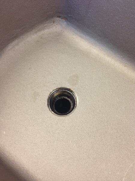

Keoke, how does one tell if the T pipe is screwed down too far? Here's a photo of mine, top and bottom.

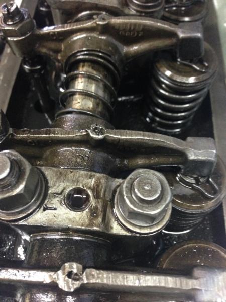

Mechanic said someone pinged the rocker arms. (why was that done?) Photo attached.

IMHO, the oil in the carb has to do with two issues; 1) adjustment to the height of the "T" pipe on the rocker arm cover, and 2) if the rocker arm shaft is becoming worn out.
Well:
just remove it then replace it using the minimum penetration -- Fewest turns down-to get it secured with the lock nut.
However, your valve cover does not have a baffle under the "T" pipe-????
I don't have points, running Pertonix. So why do you think the timing changed?
Incorrectly set initially . Ole pertronx do not change timing once set.-
Good point. That baffle would help slow the oil down. I noticed some oil pooled on top of the rocker pedestal. On mine (with a new rocker shaft) oil doesn't collect there.

Pinged most likely worn rocker shaft.
