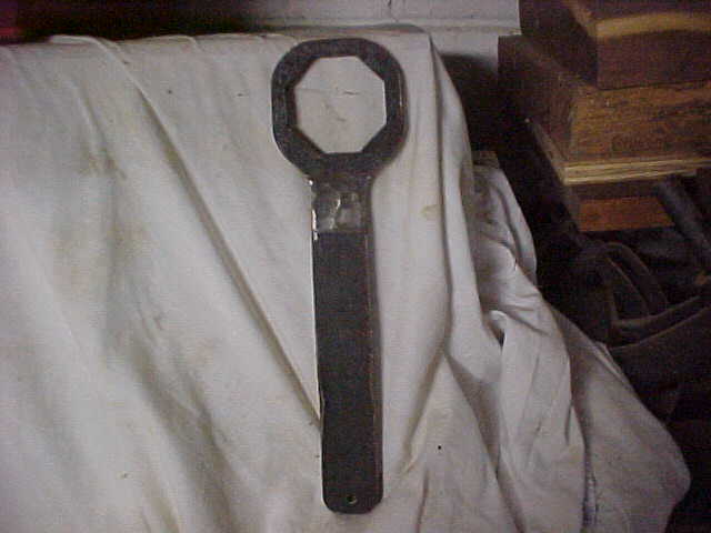

keoke, remember this????........ :banana:
Yep, has to be an eight-sided sucker, though with one (1) wheel stud knocked out, you can use a fifteen inch (15") Crescent Wrench. That's what I used before I had the tools to make this:
OH Yeah!!, this is that rusty thing you found in the swimmin pool right.--Keoke-- :laugh:
