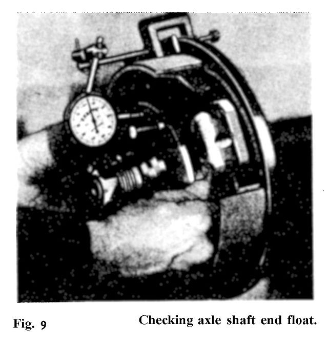

Yes, the previous owner had apparently had the axles out for some reason (perhaps swapped with another car) and reinstalled the 6 bolts per side without the retaining tabs. The number of shims varies quite a bit (plus they come in different thicknesses) so really checking the end float is the only way to be sure you've got the right number. With both axles installed, it should be .004" - .006" at either flange.

I would think you will use the same shims that come out but, of course, check the end float anyway. In fact, you might see what the end float is before you R&R. .004-.006 is just about at the limit of movement I can feel when I tug on the hub.
