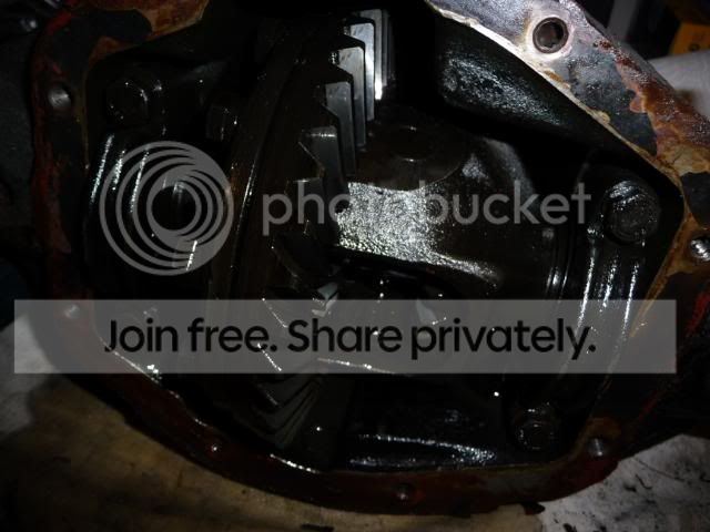

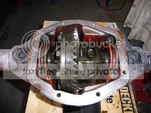

So after I wiped off the grit, I noticed that the inside of the housing is painted red. Bearing holders and all. Is that normal? It's hard to tell, but the outside may have once been red too. I have a feeling it's been gone through before and noticed the lack of a cotter pin on the pinion nut.
Everything seems tight and I found no metal -just a lot of dirt, some of it no doubt from the flooding. But my replacement pinion seal is a little different than the one I took out. The new one appears the same from the outside, but the old one also has a metal case on the inside. Pictures are of the inside/outside of both with the new one on the right. -The distortion was caused during removal so pay no attention to that. The new seal fits more snuggly on the flange and looks like it will fit into the housing. Does it look like I have the proper seal?

Seal looks fine to me. There have been several different types over the years, ISTR originals were actually leather instead of (synthetic) rubber.
Haven't seen any red paint like that, but doesn't prove anything.

Mine was red like that too - I noticed a little bit on the outside, but not much. Is that what they call a glyptol treatment like on the inside of an engine?

Looks like Glyptol paint. Mine was a different shade of red though (can you believe it!?)

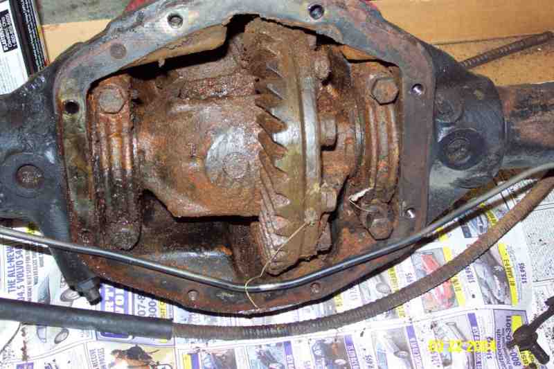

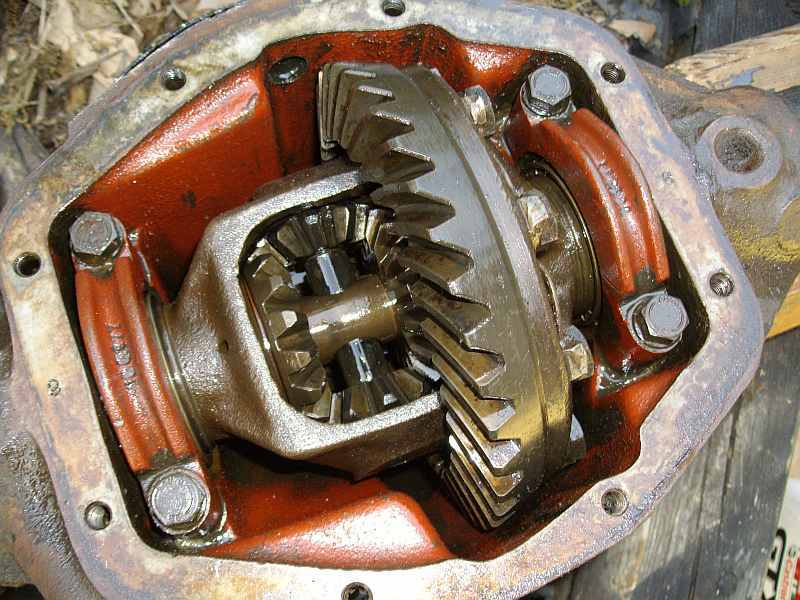

A couple pics of mine....
3.7 black inside
4.1 red inside

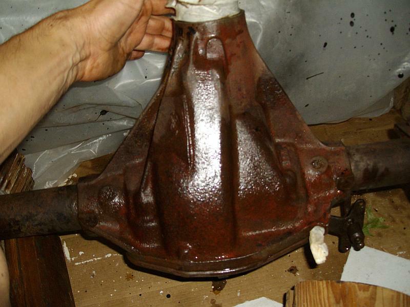

Sooo, assuming I hadn't made the leap in mind-set from 'just get er runnin again' to 'everything must be exactly as original'... I noticed the outside of the differential appears to have also been the same shade of red. But it's more difficult to tell if the axle housing halfs were originally red. They appear black now. Some POR15 was on the diff (on top of the red), but applied on top of the existing dirt and grease, so it came off much easier than in places where it was applied directly to rust. When I scrape the black of the axle housing, there is rust under it -no red. This picture was taken after cleaning with simple green and rinsing with water; that's why it looks wet.
Does anyone paint the 'pumpkin' red and axle housings black?

If you look at my pics on the left hand side of the diff where I started to clean it up, you can see feathering of black and what looks to be a redish base. I thought that the red was just a red oxide primer though...

TR4nut
I saw red on the outside of the pumpkin too, but not on the axle tubes. And it seemed to have black paint on top of the red - did you see any at all?

The differential cases and covers were initially supplied by two or three local foundries (near Coventry) and then eventually in house at Standard Triumph. They were sand cast. The quality was "average" and typical for that period it was common practice to "dip" these parts in GE Glyptol or equivalent. The primary reason was to help seal up any excessive porosity and to encapsulate any particles of sand left over from the foundry. If you crack open the case and don't see orange-red, it's a sure sign that the unit has been hot-tanked prior to a re-build.

But I've never seen a car with a red diff. If only the pumpkin was red, it might have been painted black when the frame was sprayed? And perhaps, the black doesn't wear as well as the red?
I can't tell if any red was on the cover at all, ever. The inside of the cover is black and some is missing. The red on the inside of the case is like new.
That's my guess- I think Frank has described what I was wondering about - if the pumpkin was dunked prior to adding the axle tubes, then everything was painted black after assembly. My outside case was definitely black, and not just from the grease - and when I scratched I can see some red but didn't realize the whole thing might be painted.
