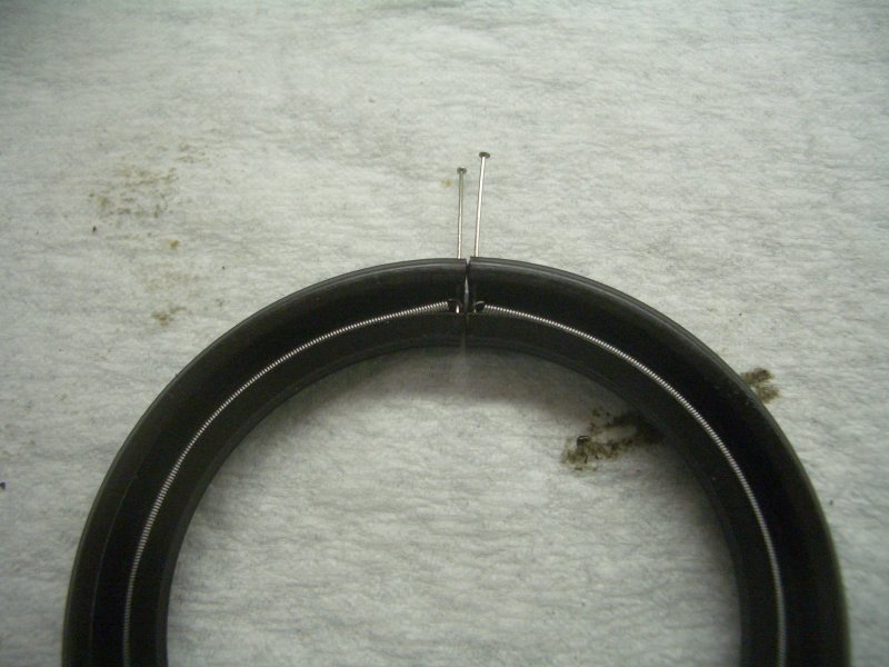

I captured the ends with straight pins, which allowed the correct orientation of pointing the spring inward toward the engine:
This worked great from 2008 until the present when I'm having my engine rebuilt.

Thanks for the replies. Steve, I saw your solution on an earlier post, but I did not realize that the pins were permanently installed. Seems like a good solution.

Task completed. I dry fit the spring in the seal and it was relaxed to the point that it fell out when I turned over the seal. I cut off two rounds to start, and it took two more to get the spring snug when fitted in the seal. Steve - I tried your pin method, but the pins I had were too thin and just bent without ever penetrating the seal. I even heated the pins with no luck. I used a method similar to Bob's suggestion to roll the spring in to the seal. I used two pick tools kind of like how you use tire irons to mount a tire on a wheel. Done. Thanks for all of the suggestions.
