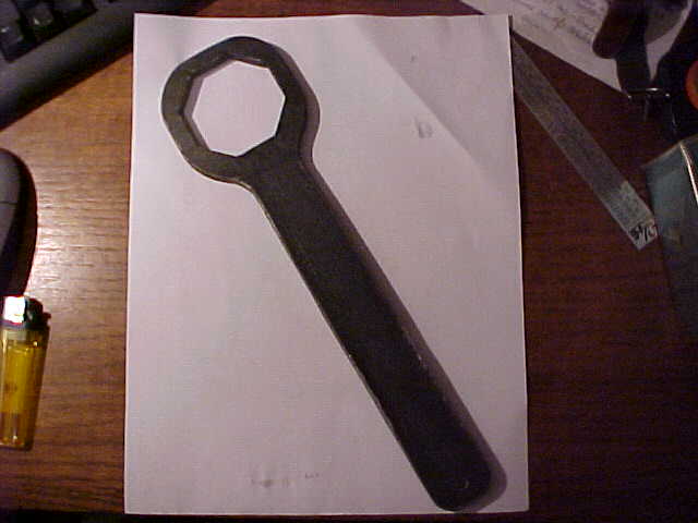

ausmhly,the size of the axle nut is 2-3/16, given the tightness of this nut 140 ft# and the fact that the nut does no show enough of its face/pojection form the axle littlie over 1/8" youll find the use of a socket a clunking banging around afair also gived the fact that the socket will set yo back between $50-$75 i elected to make a wrench, also if you buy a socket you might find youll have to grind down its outside diameter to get it to fit snug on the nut as in "thin wall" sockets, the only advantage i found is that a tourque wrench is much more adaptable to a socket, id take the advice of others given here to change it now, and not try to just "retighten" it , if you bugger up the nut i.e attempting to drift it loose with a punch,well just add $30.00 to your parts prices and do purchase a "new" locking washer as well as the "o" ring and seal. left side/drivers side wheel=clockwise ratation to remove, right side pass.side = counter clockwise rotation for removale.fwiw. wrench i made see attch, keoke hates this thing thats why i love to post it so often /ubbthreads/images/graemlins/devilgrin.gif - /ubbthreads/images/graemlins/savewave.gif

I thought he was talking about the drive shaft flange on the drive pinion, not the axle retainer. But I do get confused easily. Very nice wrench you made though.

I think there is still a communication error here. Anthoney's wrench is to remove the outer axle hub nut & is 8 sided, 2-13/64", Moss #62. It is a very nice wrench for it's intended purpose.
The nut under discussion is the drive shaft flange nut, Moss #43 as you say. It requires a 6 or 12 sided socket & is considerably smaller in diameter. However, it should require a good bit of torque to remove & tighten it, & requires a method of holding/locking the flange to remove the nut. A long bar that is bolted to the flange via the U joint bolts works well. You "might" be able to lock the brakes on to hold the flange & nut while applying a lot of pressure to the nut with a long socket handle, but doubtful. I personally would use an impact wrench to remove it.
