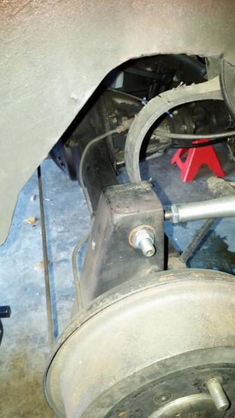

I noticed my car was lacking rear axle rubber stops when I bottomed out rather hard some time back, so I ordered new rubber bumpers. Now from what I recall on my last car, there was a bracket they fit in. Attached is a pic....am I missing that bracket?

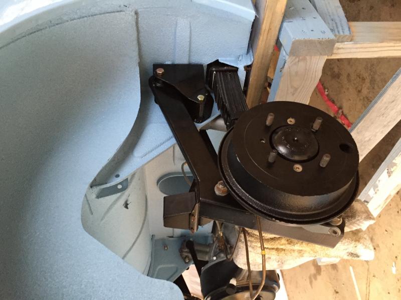

Edd,
Heres a picture if my rear end!😁

Thats what I thought, that bracket is missing on mine. Might have to bend up some metal and tack it on there.

My wife says that all the time! If the brackets not available you might want to think about drilling and tapping a hole and mounting a generic bump stop.
