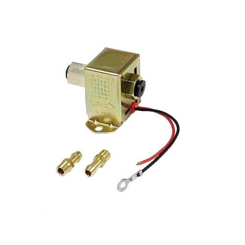

I know you like running these, and I am using one exactly like this;
I was running it directly off the battery while using it to draw fuel up from a gas can while trying to the MGC to run. It was connected like that for about 30 minutes.
When I went to take everything apart I grabbed the main body with my hand and it was really hot. As in almost dropped it as it as about to burn my hand hot.

Sorry, Tom, I've never used a pump like that.
However, looking at the shape, I would <span style="font-weight: bold">guess </span>that it is a motor-driven pump intended for high performance and/or fuel injection applications, that relies on constant fuel movement to keep the motor cool. It should probably have a bypass line back to the tank (or in your case, can) so that fuel can move even with the engine not running.
Both Carter and Facet are brand names, they both make several different kinds of pumps. The 'Facet' pump that I recommend looks like this:

You are showing a picture of the Carter pump. It is extremely important with the Carter pump that you do NOT let the fuel run out or let the filter get plugged. The pump is cooled by the flowing gasoline. If the gas stops flowing for any reason the pump WILL get hot and the innards of the pump will melt together. I like the Carter pump and "had" one on the GT6 until I melted it due to a plugged intake filter.
I have never felt a square body Facet pump to see if they get hot.

They get a little warm, but not what I would call hot.

That Carter type pump looks like it may have been a submerged hi pressure fuel injection pump. It sits in the tank and the surrounding fuel cools it as well as the flow.
The high pressure submersible pumps get HOT when run for exteneded periods outside a tank.
Very LOW fuel pressure is needed for carbs, otherwise the float needles will blow out and overflow the carbs.
If you get the facet, stick with the low pressure pump and place it near the tank. they push better than they pull.
T
tdskip
Hi there - that pump actually has exposed wiring leads so it's an external mount, but no doubt now that it requires continuous flow. it is a low presure pump, and didn't flood the carbs, but it isn't a good choice for non-injected LBCs as it turns out.
