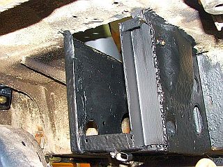

I was looking into my battery compartment and much to my surprise I saw the road from several angles. Is this normal, or am I missing some lower panel of some sort?

Your battery bins have rusted out which is typical. These plastic bins are cheaper at Victoria British.
Gary

Maybe and Maybe not. The original battery compartment was not much more that a frame work of angle iron with an open bottom.

You're probably OK....This is (almost) what your battery box should look like. Mine has been altered to accomodate a four-link rear suspension. From the factory, it is open on the front, back, and bottom.
This is a 1974-1/2 MGB/GT.

As long as the angle-iron is intact you're OK. One issue to be aware of is that there is a potential for buildup of explosive gases if you put your battery inside one of those plastic bins.
I never though of that. I guess drilling a hole might help to vent it out some. I just worry about acid causing damage to the frame or the surrounding area.
