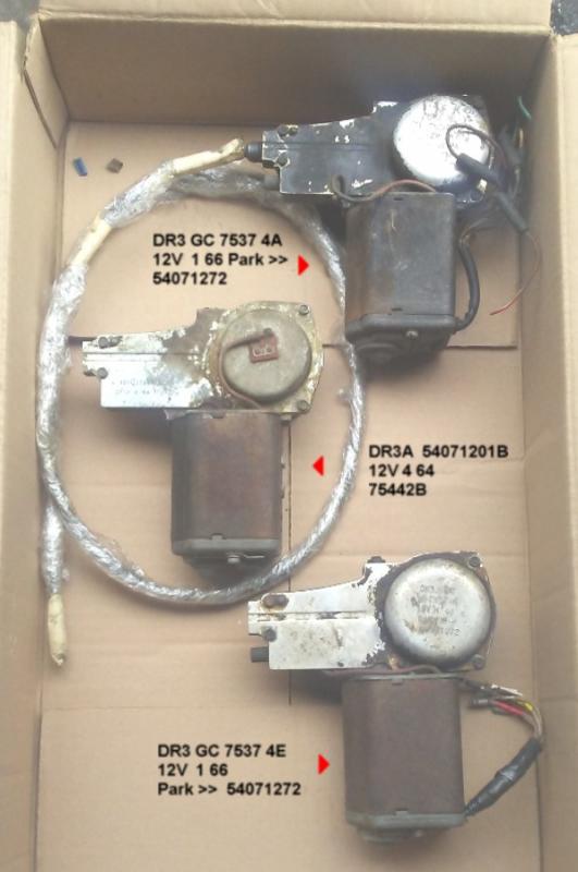

Dave, I have 3 DR3 wiper motors in various states of decomposition, one has original cable.
also, EAST COAST JAGUAR in Delaware has the parts, rebuild services, and/or exchange for rebuilt motor.
