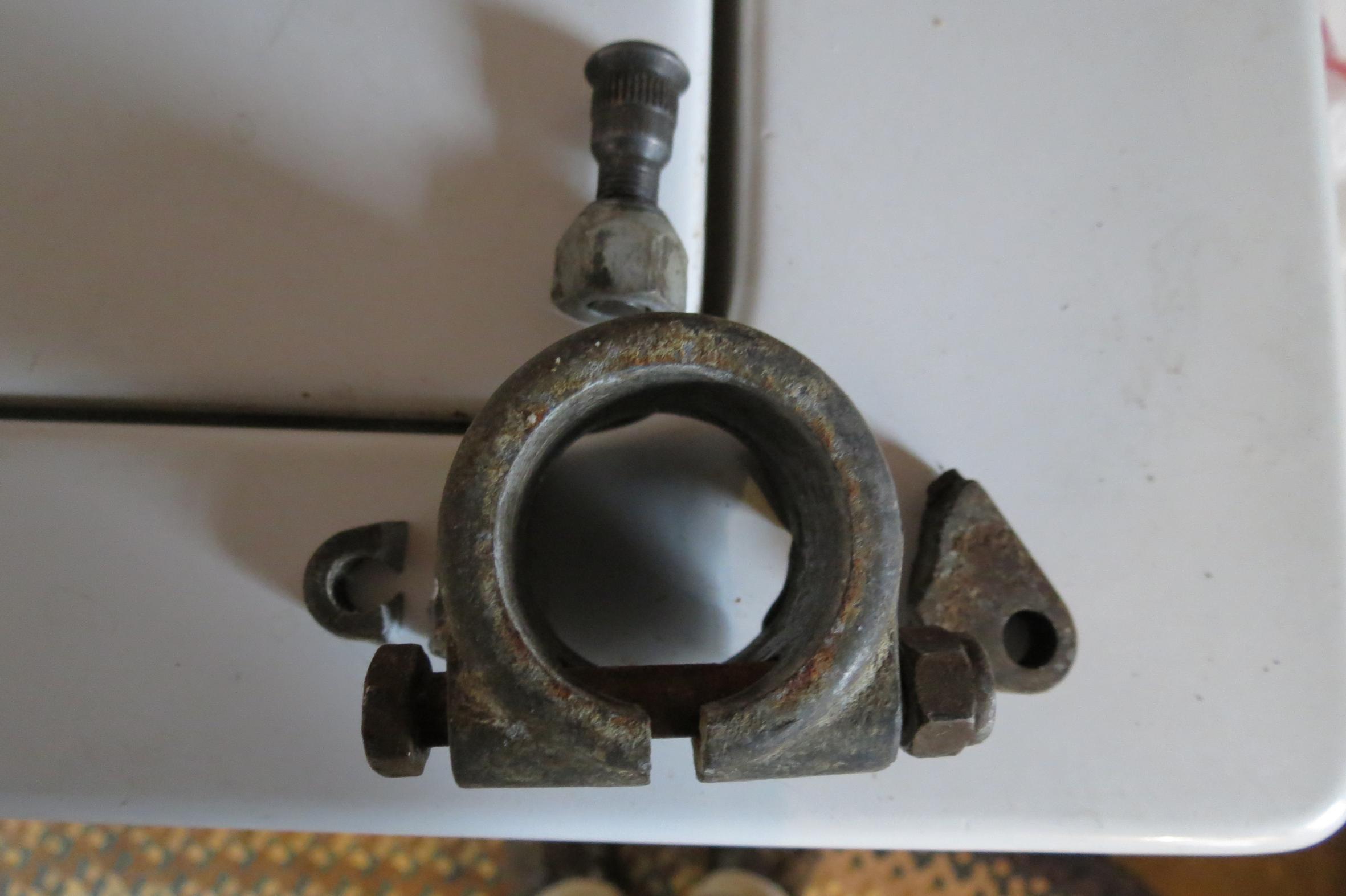

Good idea, Rick! The garage called this morning and said they had discovered the circular bracket that holds the slave cylinder in place had broken and requires replacement. It's in the Haynes Manual and sort of looks like the similar clamp arrangement that holds the distributor down and in place. I'm trying to find a replacement one now; Vic Brit doesn't show it as a piece and I'm checking the major catalogues now. I'm also trying a few sports car shops in Maine to see if anyone has a parts car.

Lucked out and found a used bracket in good shape at Penn Ridge Motors here in Maine. Tim Hutchison had one, bead blasted it to make certain it's strong and will ship it to the garage today. Hopefully that's all that's required.

If it is the part I am thinking about it's hard to imagine how it failed. Please get the broken part back and post a picture.
Hopefully the garage was able to remove the bracket from below in the narrow space that is available. Removal from below will cost a lot less than if they had to pull the tunnel cover.

Yes, Doug. I'm hoping the same. I'm sure they will try and do it from below. The mechanic said he found the problem by looking under the bonnet. They usually save the parts for me so I should be able to post a photo.

Wow ! I didn't think it would be possible to break the ears off of that cylinder mount. Is there evidence of corrosion damage around the bolt holes and/or where the ear broke?
