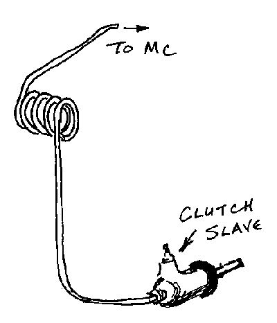

It would be real easy to make a clutch line out of pipe, but due to engine/gear box vibration, it would soon break.
A lot of small town parts houses also make hydraulic houses. Said parts house may be able to make you a hose for a little less than $30. Haven't done it so I can't say for sure.
bugimike
The solution to the vibration problem can be found on Bugeyes which came stock with "hard" lines. To dampen the vibration effects make the pipe coil(about 4/5 coils will do!).
