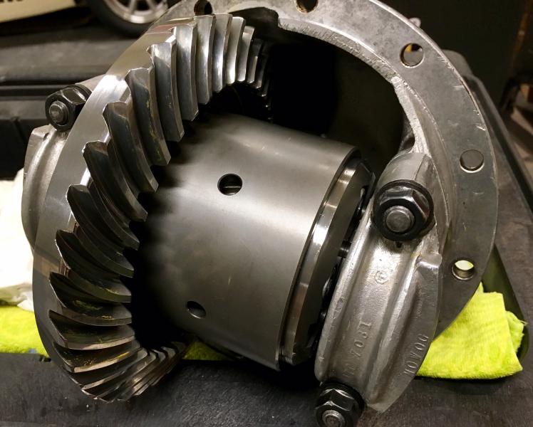

Or you could have your gears REM treated before installation, https://weddleindustries.com/services/house-rem-polishing-process-weddle-industries
I have all my race gears REM finished prior to install.

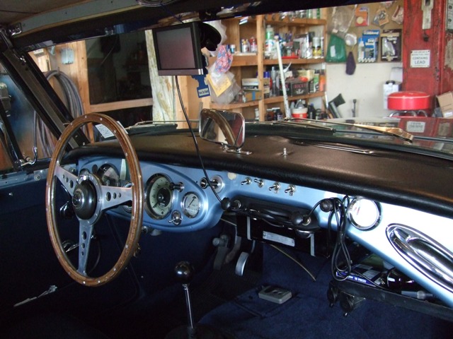

Rick - did you mount it under the dash?
HealeyRick
I tried that, but it makes too much noise mounted in the interior. You could mount it in the engine compartment, although it's pretty noticeable if you are trying to maintain an original appearance. I mounted it on the chassis rail next to the transmission. It's not waterproof so I sealed all the edges, don't drive in the rain often, and so far it's been fine after 2 years.

If you don't want to go to the time and expense of having either a converter box or a converted speedo why not simply use any one of several phone routing apps that give you accurate speed and will even generate an audible warning if wanted. I use WAZE and think it is wonderful--in addition to accurate routes it tells me my speed and the presence of speed/red light cams ahead plus traffic jams, etc. etc.

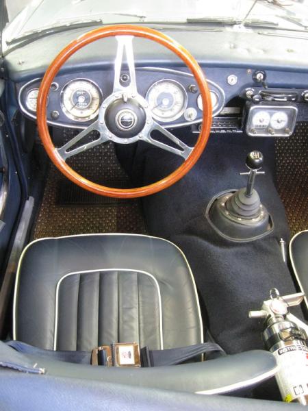

The nice thing about the Classic Speed or a converter box is you get to keep your own instruments. The aftermarket GPS speedos are pretty neat, but they don't look original. You can get the Speedhut gauges with some custom work that I've seen the Sprite guys with, but they don't offer a speedo that will match the gauge color for those of us running the ivory stock gauges. Speedo shops in my area are nil, so the option of a converter box was out for me. Even though I have a V8 in my car, I strove to keep the car as original as possible, including all the gauges. It was a bit of a struggle making Ford and Smiths play together nicely, but I think it was worth the effort as all the stock gauges now successfully monitor the Ford's vitals:

Thanks. If all you are doing is changing rear gears, the simplest thing to do and probably the least expensive is ship it off to Nisongers after giving them a call and the rear end has been installed. They will give you directions on how to measure the distance your car travels in one revolution of the rear tire and send it to them so they can recalibrate your stock gauge and use your stock speedo cable. Because I am using a Ford transmission, I had to get a bit more involved.

I got a GPS fix too. Real easy, convenient and cheap.
