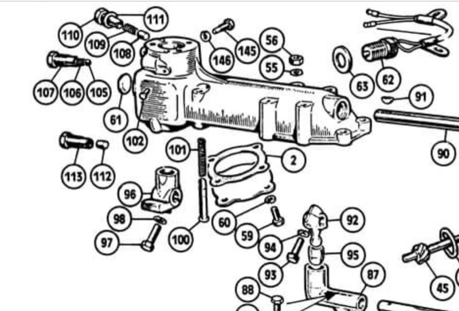

Having trouble shifting into reverse gear after car has sat for several years. Other gears work fine. Question; would reverse be more stubborn based on a poor bleed of brake system?
RickF
If you can shift into 1st through 4th with no issue then the hydraulics are not the issue. Reverse gear uses a shift fork separate from the other 4 gears as well as a mechanism in the rear shifter extension designed to make it hard to accidentally shift into reverse. Sounds like the lube is drying up on these parts from lack of use. Parts number 100 and 101 are the reverse protection plunger and spring.
