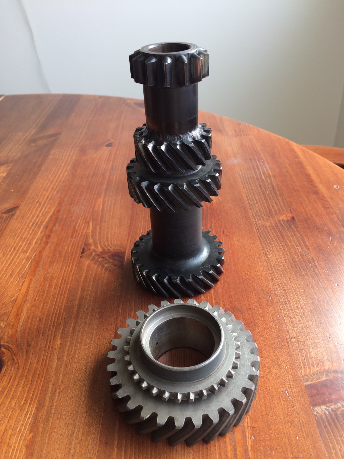

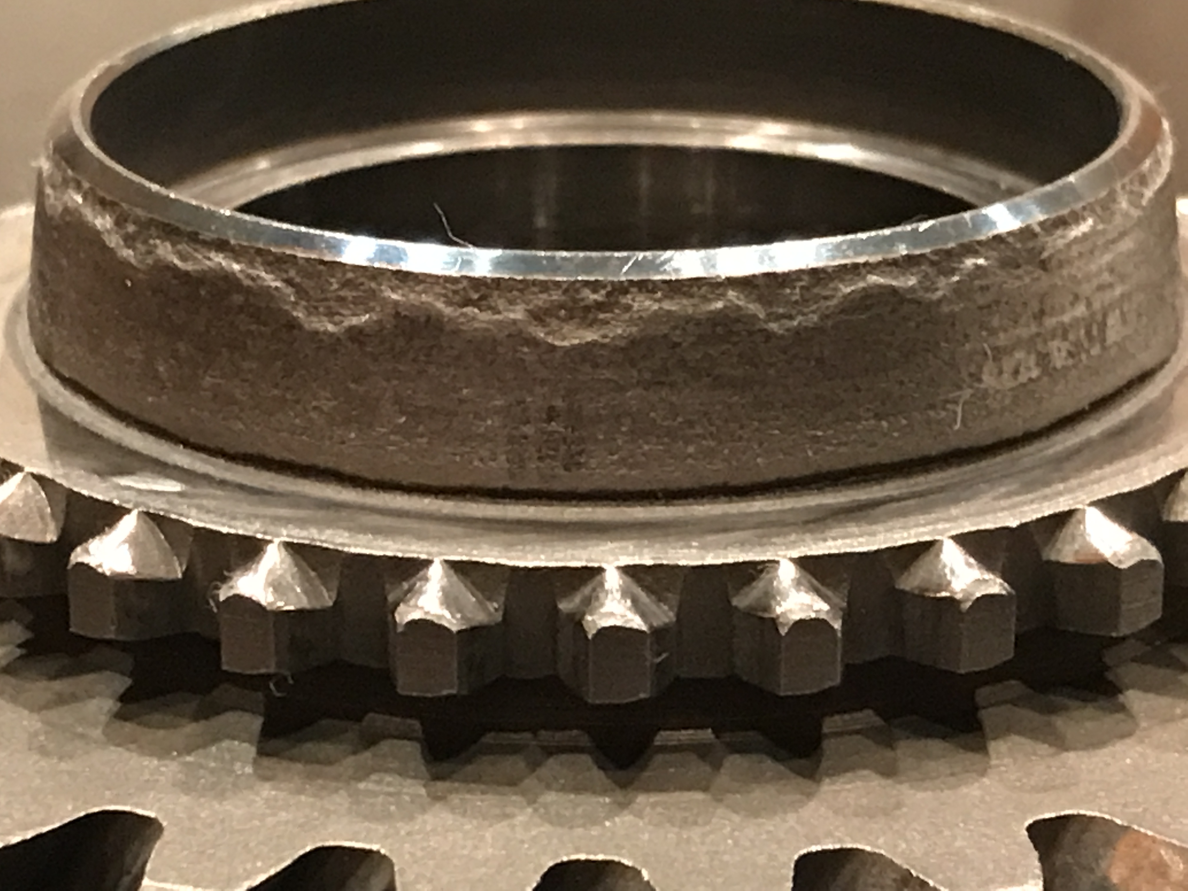

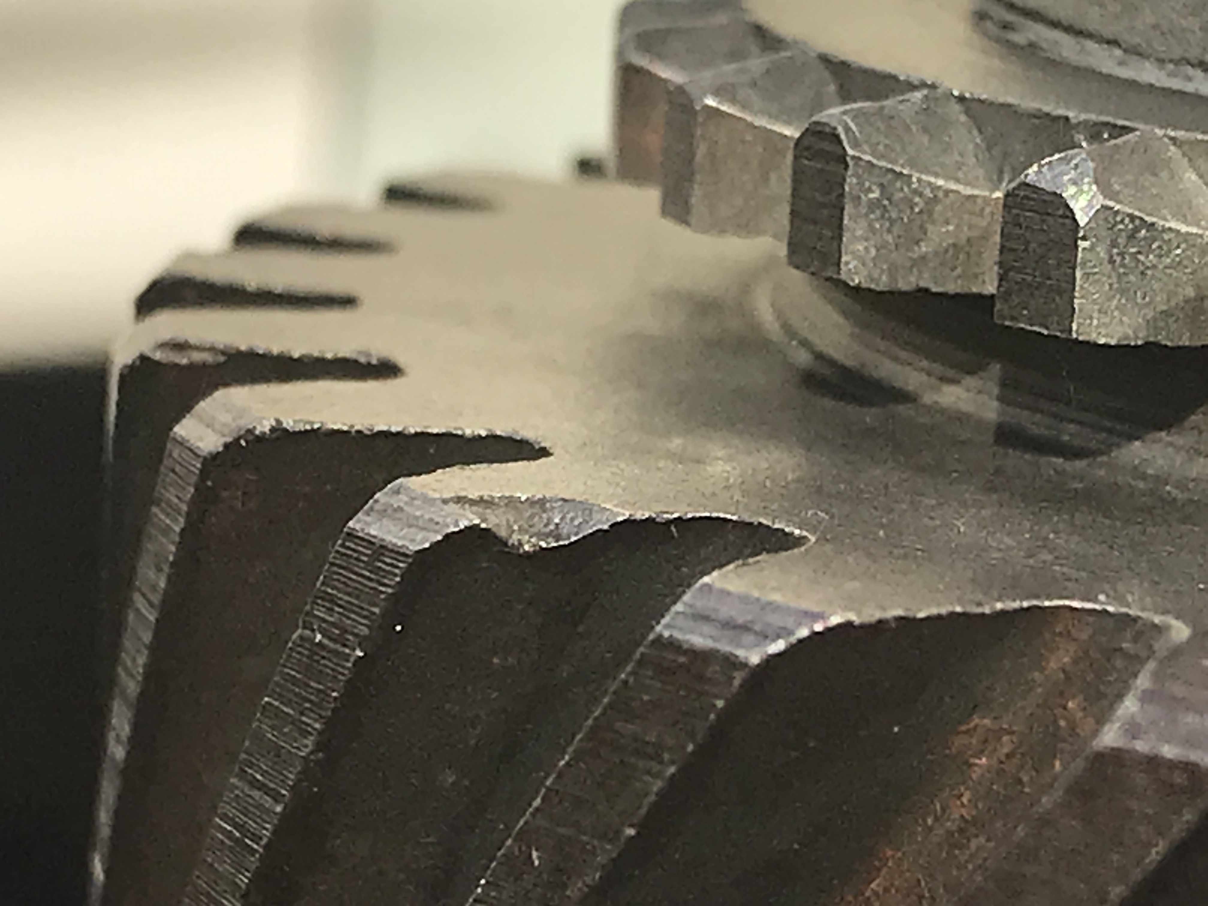

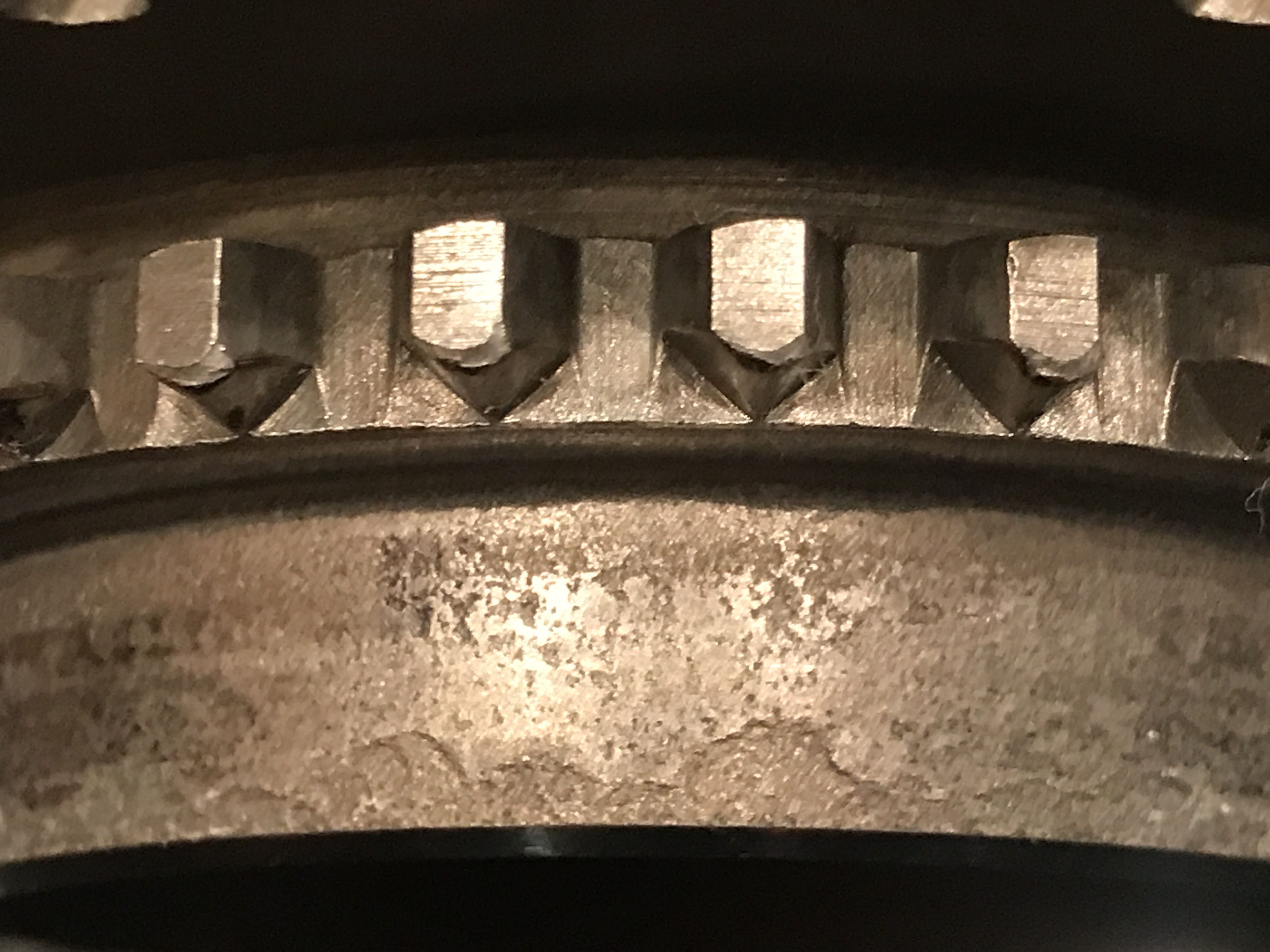

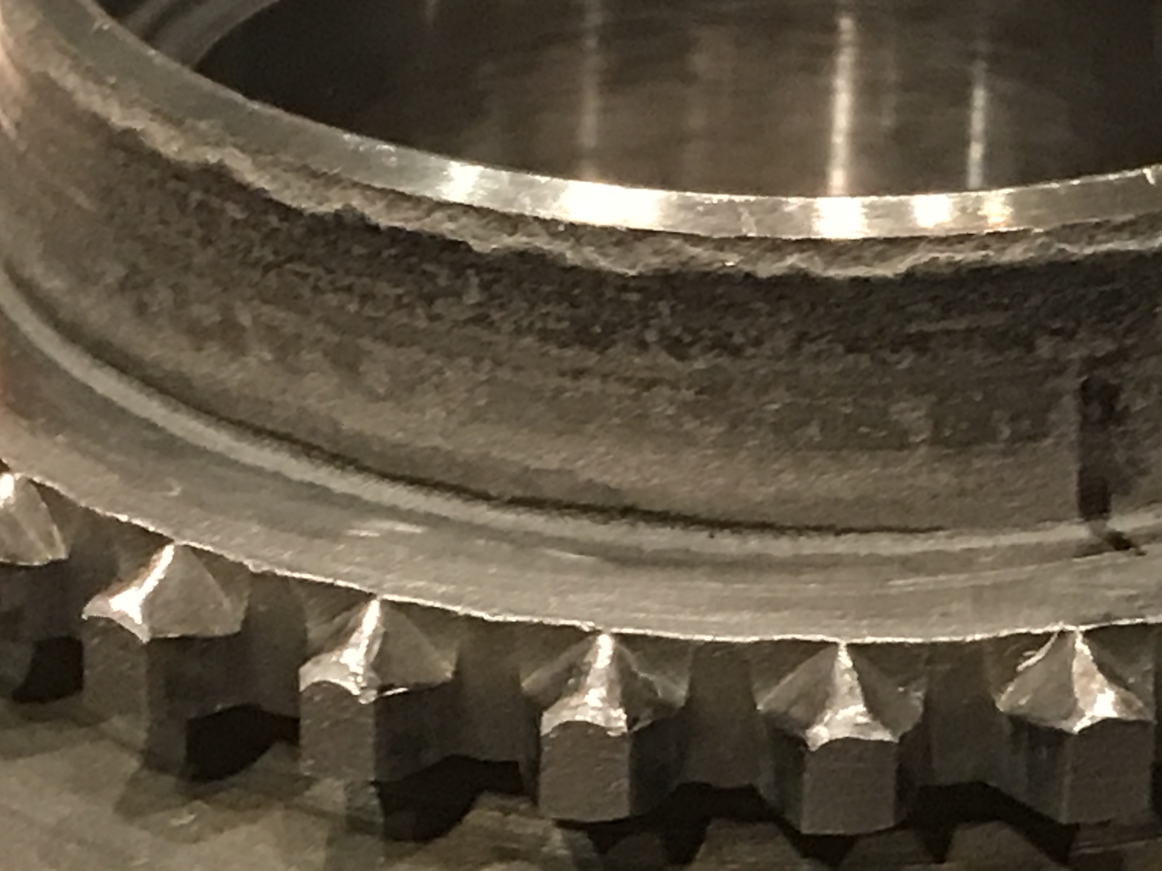

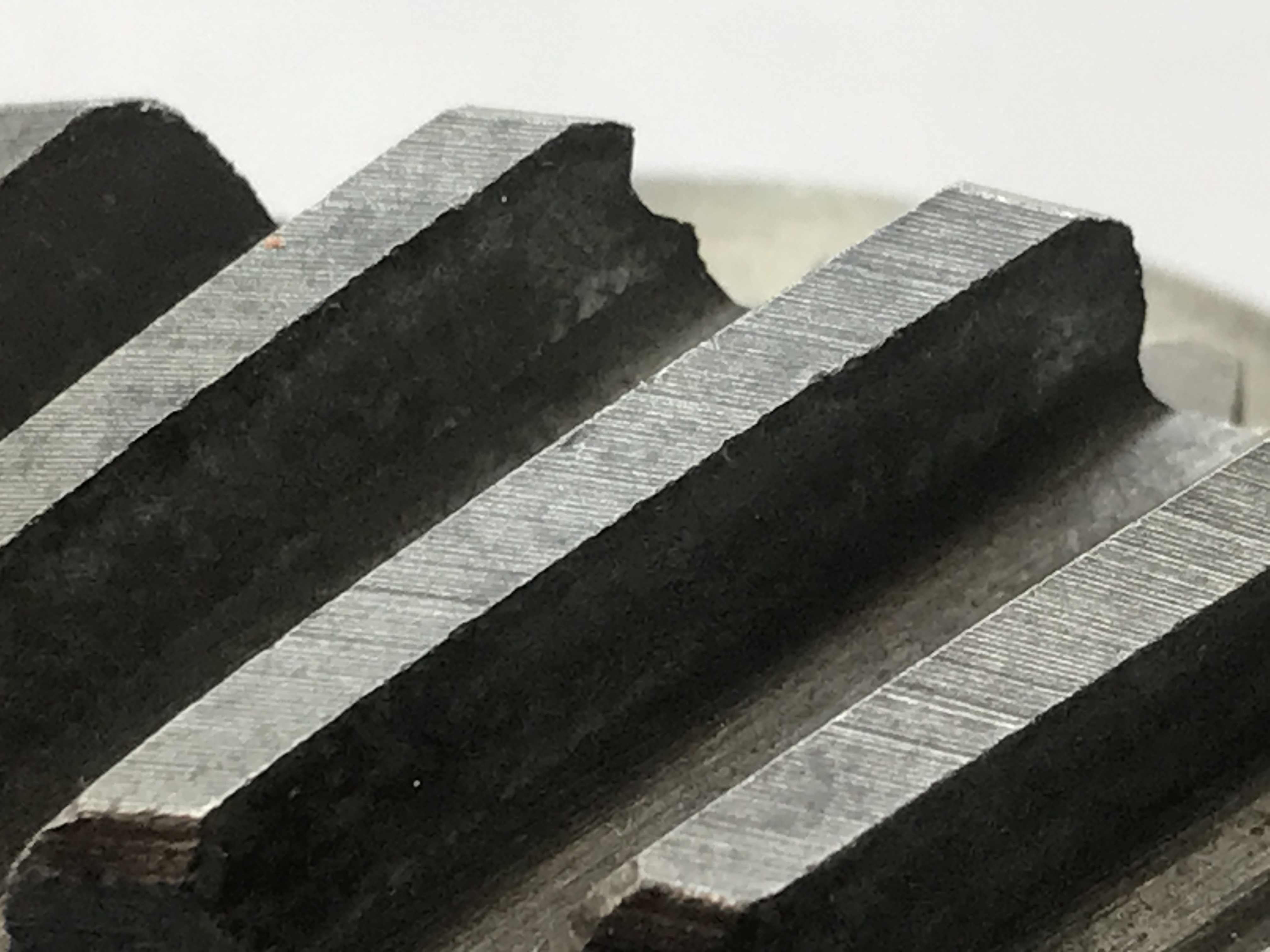

Finding 2nd gears is a challenge. Here are some photos of the one I just received.
Some of coating has been chipped or worn off, is this normal wear? Are the small pointed gears (what's the correct name for those) ok, normal wear?
1st photo is my 2nd gear. There's no coating and the baulk rings spins freely.
Other photos of the used 2nd I received.
Please let me know if I should use it or should I return it.
Thank you for you help.

I recall wear similar to your 2nd and 4th photos on my BJ8's 2nd gear (I replaced the 3/4 cluster). Since, as you've found, 2nd gears are difficult to find, and I wasn't having any issues with my 2nd--the gearbox would pop out of 4th--I re-installed it. My 2nd works OK, similar to 2nd on my BN2, which I haven't gotten into (note 2nd gear probably gets shifted into/out of more than the others). I think if your synchro doesn't slip without extreme force you will be OK; however, the wear on your 1st and 3rd photos seems to be worse, almost like they're of different pieces. My 2nd also had some wear--maybe a bit less--on its teeth.

I see two problems with the replacement you received.
First, the built-up synchro surface is very rough and looks like some of the material has chipped/worn away. I think this would cause excessive wear on the new synchro rings. And, if any more of the built-up material flakes off, you could have metal bits floating around in your box.
Second, the engagement teeth on your original are still quite sharp which helps with smooth easy engagement and the ones on the replacement are quite rounded/worn which will make engagement more difficult.
Clarifying: I disregarded your 1st photo, since it was of your old 2nd gear. '1st' and '3rd' and '2nd and 4th' refer to your four photos of the 'new' used 2nd you procured. At any rate, you probably have enough material for your 2nd to work OK (again, I'm not a hexpert). I dunno if Randy F does this anymore, but I think he recommended building-up the conical surface with some kind of coating; it might be worth considering.
I recall years ago, there was an issue with poorly-machined synchro/baulk rings causing some issues; presumably this has been corrected. I bought DWM's synchros for my last rebuild, and they work OK; some occasional issues getting into 3rd (have to speed match accurately to avoid slight grinding).

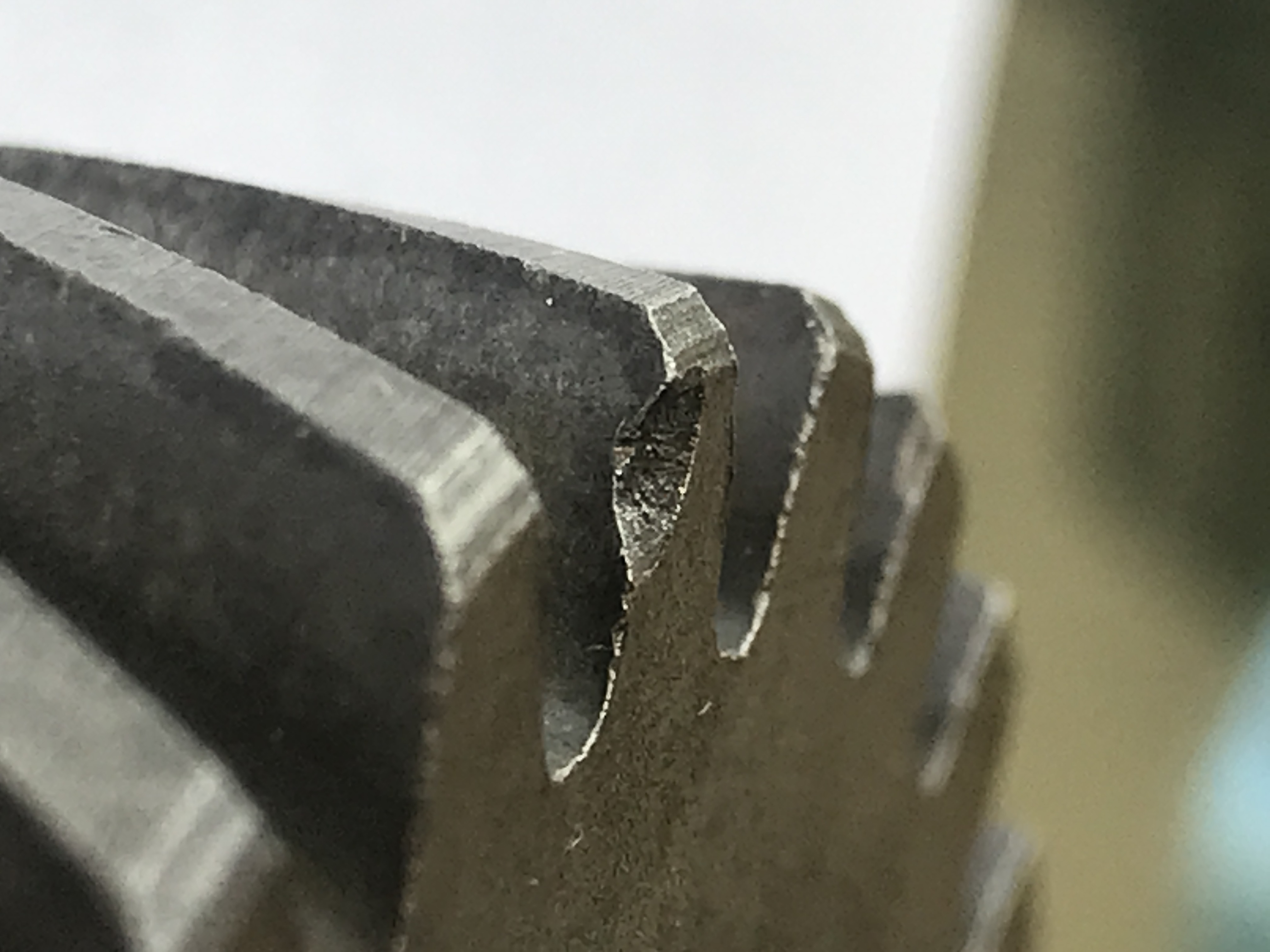

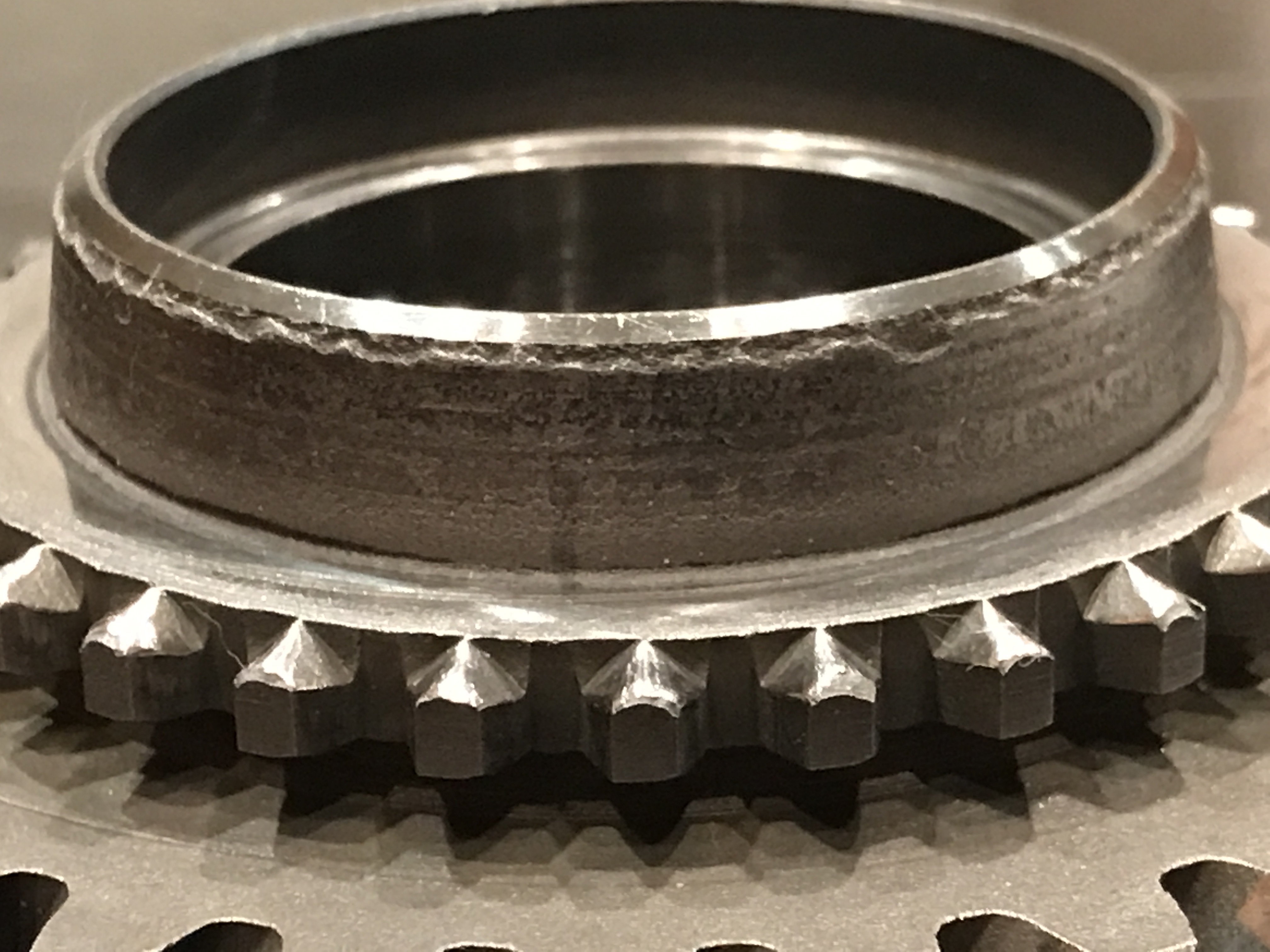

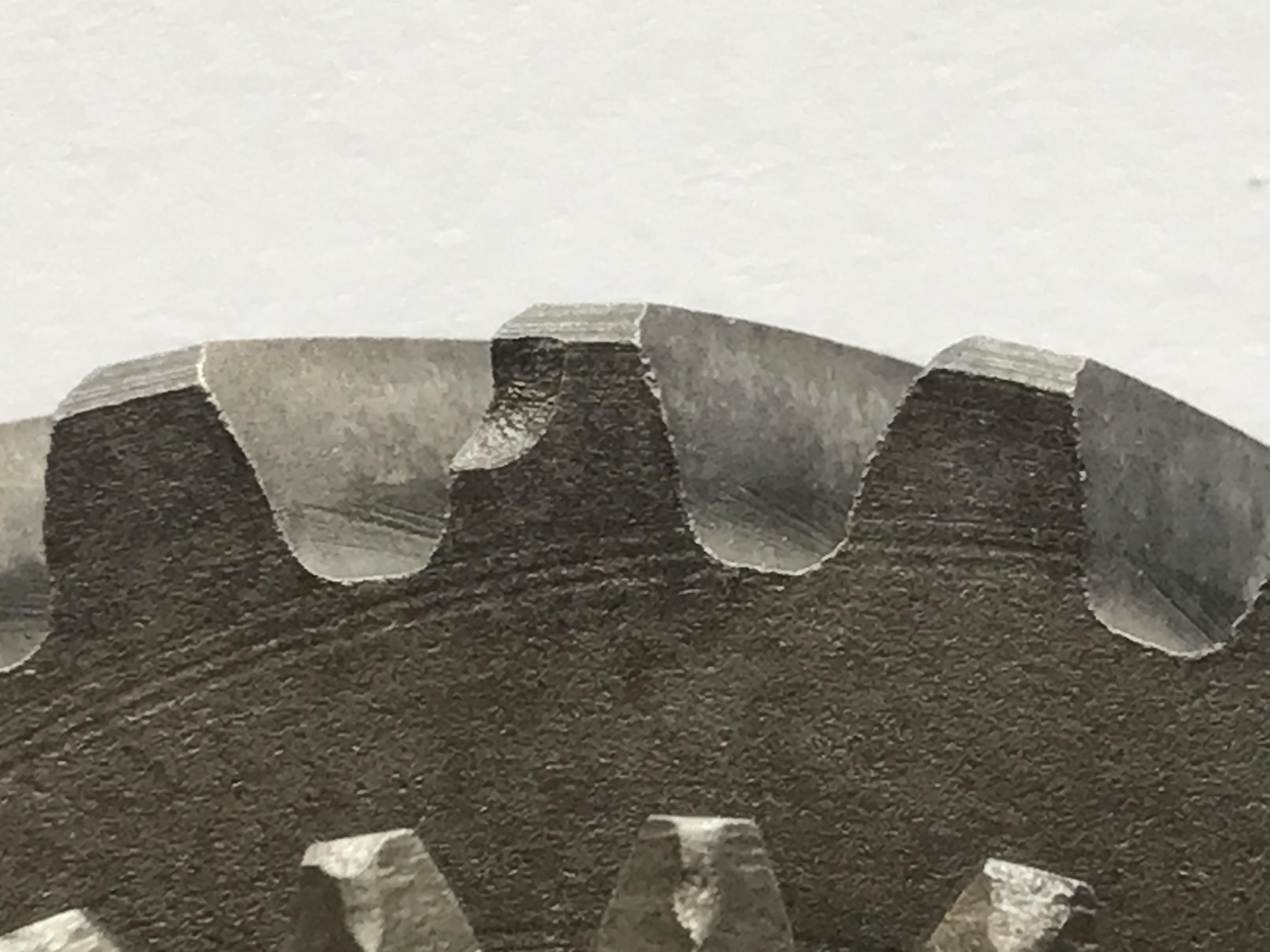

I now have another 2nd gear. The coating looks much better. One gear is chipped. I showed this to the mechanic and he said you might want to file the cut out edge of the chip smooth. Your thoughts?

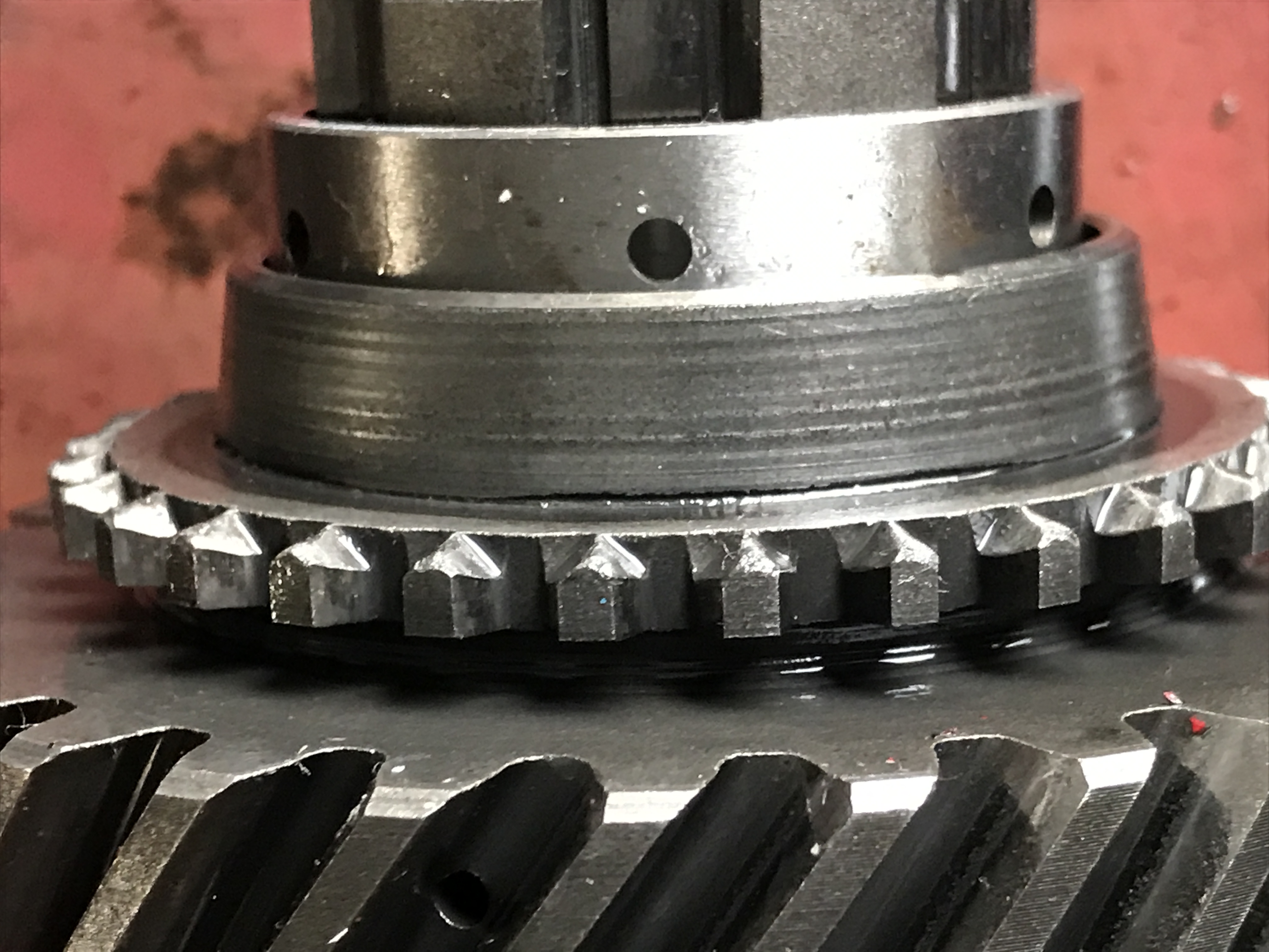

When looking at one of my other gears he said it looks like the hard coating is coming off, and that it will wear quicker because of that. I'll assume he has trained eyes, for I could not see any coating. Is what he says true? (I'm attaching photos of my newly acquired 2nd gear. It looks original. I don't see any "hard coating").
The welded rebuilt laygears seem to have a dark coating. (photo attached) What is that coating?
Next to that laygear, you'll see the 2nd gear I bought and showing close up photos. Your thoughts about the chip in the tooth? File the edge of that chip or not?
