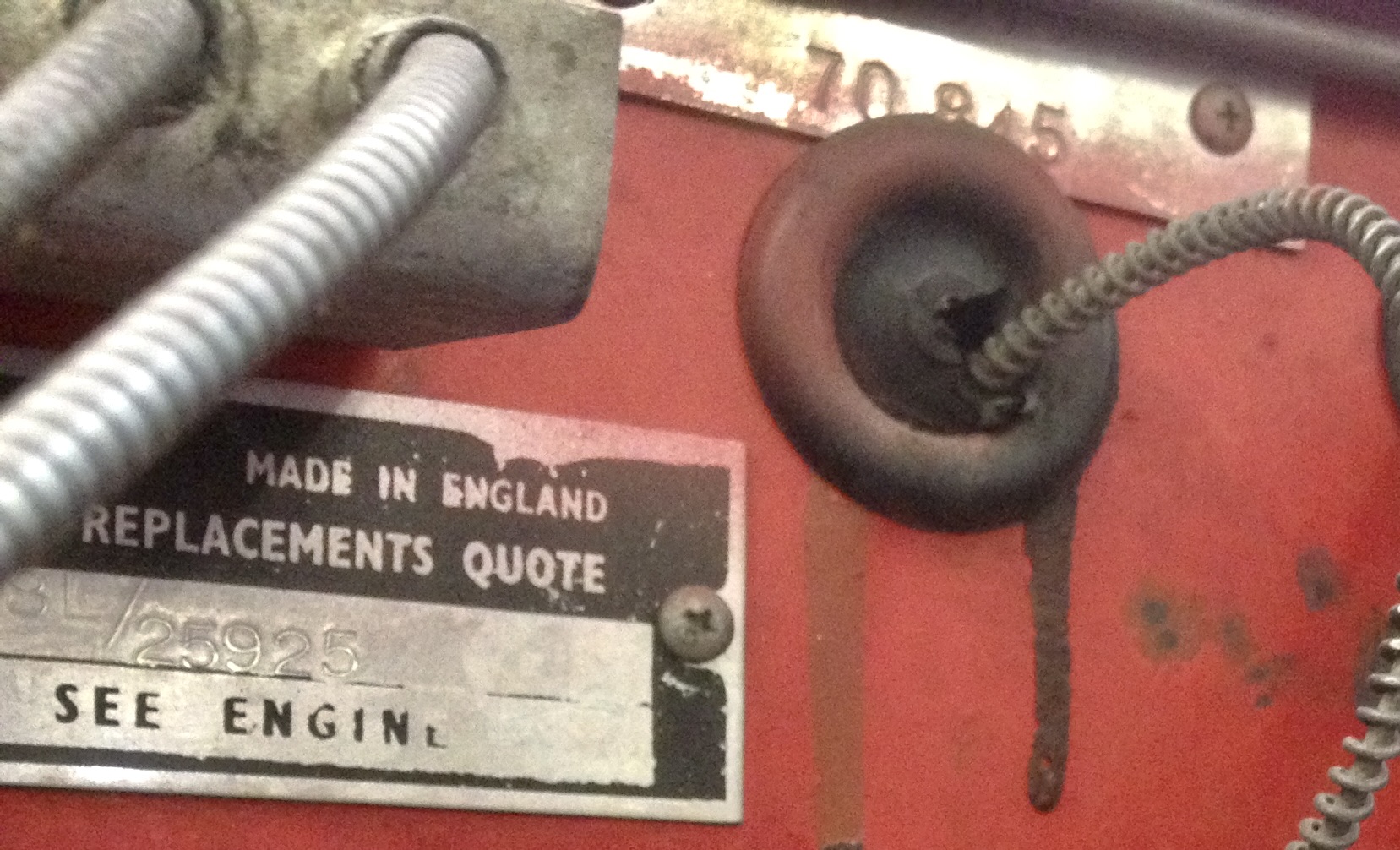

I have restoration photos of mine before the restoration, and the VIN as well as body number are visible on the firewall. Body number is upper right. The engine number is located as shown. Hope this helps. Dave
