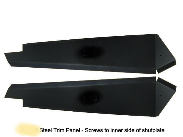

I am just about to upholster the rear liner assembly compartment on my BJ7 . This consists of a metal section fixed to a plywood panel. Can anyone tell me how the plywood is fixed to the metal panel - rivets ? Photos attached of item in question

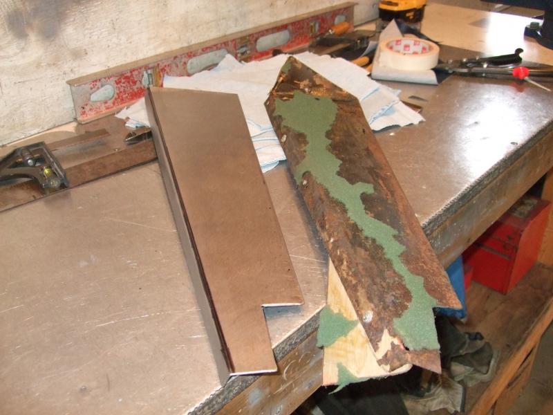

Greg, my memory isn't too good but looking at this pic makes me think they are rivets.

Greg, may I ask where you found these trim panels? I don't remember seeing them in the Moss catalog.

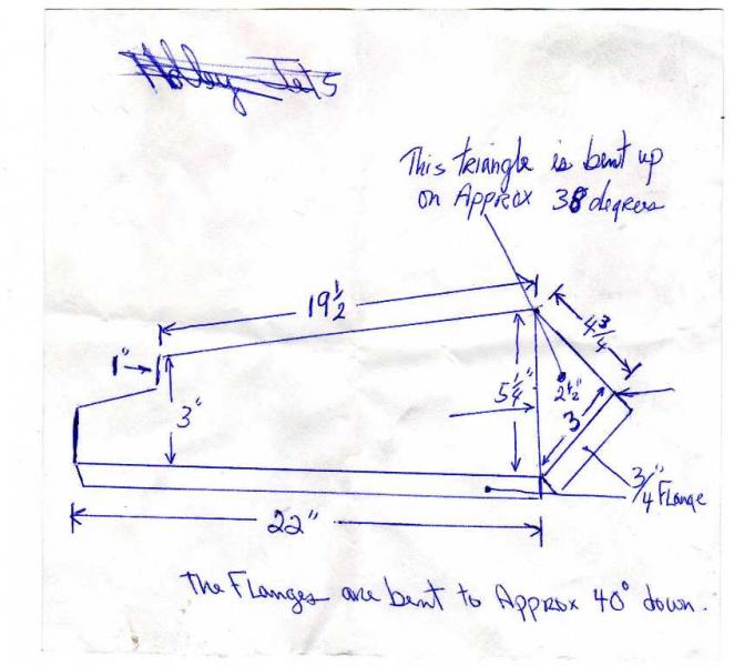

If someone wanted to make a pair, I'm pretty sure these dimensions would get you there.
