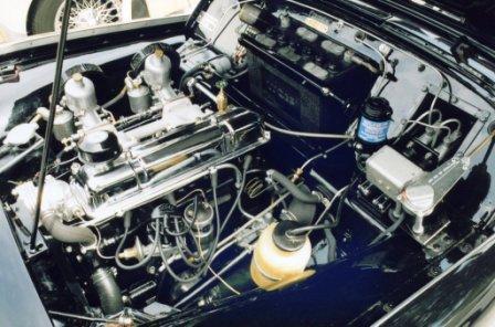

Don Elliott
I have never used or bought a battery box to contain the battery acid. The secret on a sidescreen TR is not to over fill the liquid level in the cells and to have the voltage regulator set so it will never overcharge or overheat the battery which causes the acid to spit out the breather holes in the top of an original (not-sealed) battery.
Once a year when I remove the battery for the winter, I clean out the bottom of the battery box that I put in during my restoration from 1987 to 1990.
Here it is in 2007 at VTR with 17 years on it and 114,000 miles driven since I put it in.
