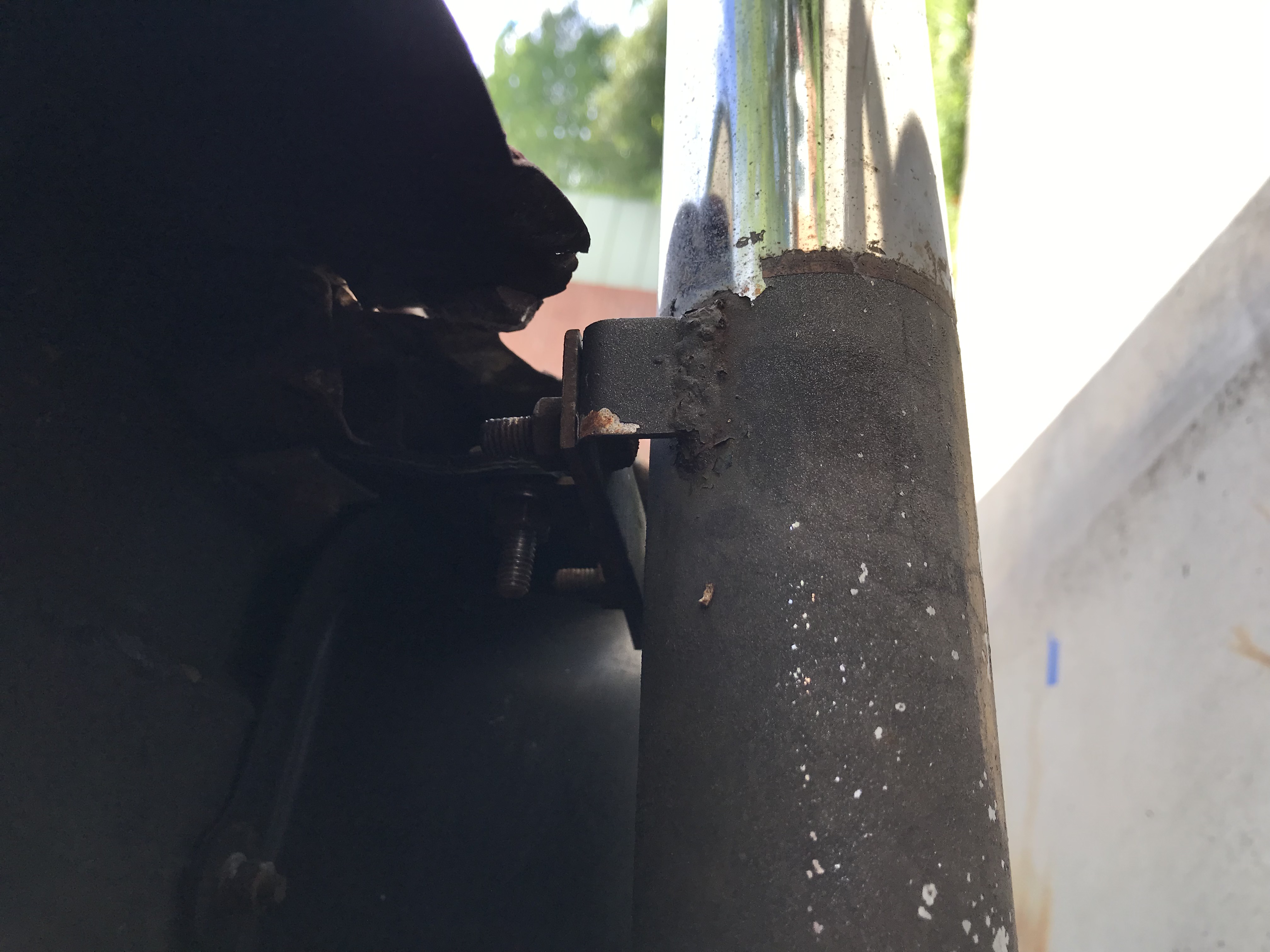

Steve--
It's not so much that the exhaust tone of the 100 is offensive but rather that the sound of a Healey six is simply so sweet and iconic.
I currently have a 2" Magnaflow coupled to the DW tubular 4-2-1 collector and though I recently adapted the system to quickly switch over to a side-exhaust I found the noise level pretty obtrusive and have gone back to the long rear-exit tailpipe. I rigged up a means of quickly and temporarily converting to side exhaust when I was planning to take the AutoTrain down to Conclave and they require 4" ground clearance. The lowest point on my car with the conventional setup is about 3-1/2" where the tailpipe bends to clear rear axle and suspension pieces, whereas with side exhaust I have 4-1/2" clearance.
As we all know, Conclave was cancelled and I would like to preserve what little hearing I have left so I have reinstalled the long tailpipe.
