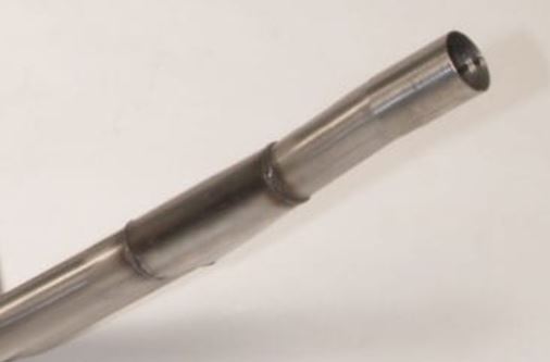

Has anyone installed the Cape/Derrington header/exhaust? If so, any fitment or other issues? Any idea what the joint ahead of the muffler is for? I'm seriously considering one (even if it just keeps my DWM steering rack company on the shelf).
red57
It's hard to tell from this picture but are you talking about the 2 into 1 collector?
No, the section of the downpipe a few inches in front of the muffler joint, where flex pipe would be on a stock muffler. Looks like solid pipe.
BoyRacer
It is solid pipe. It's called a collector. That where the 2 pipes go into one.
This is a collector?
John Turney
Yes, there are two pipes on the left-hand side and one on the right. It's hard to see, but the pipe from the center cylinders is behind the pipe from the outer two cylinders.
Ah, OK. I wasn't seeing it (obviously).
So, without the section of flex-pipe, what absorbs the engine movements and vibrations? Those flimsy stock rubber/metal hangers?
