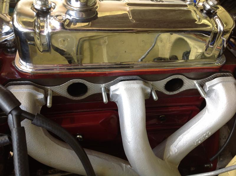

Soak or blast it and get it really clean. I used VHT exhaust paint with ceramic and baked it in a powder coat oven, but you can cure it using the engine. Cast iron would be my choice for color, but I did my MGB in cast aluminum 3 years ago and it looks like it did the day I installed it.
Rut
