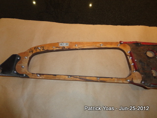

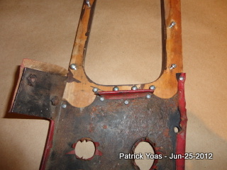

The Glovebox side is a litle trickier than the drivers side. I'v had better luck leaving the glove box attached and removing the 5 screws that attach the Glovebox dash to the center "switch" panel.
*Remove the 5 screws that attach the Switch panel to the Dash.
*Remove the "nut" on the highest part of the backside of the Dash.
*Remove the bolts that attach the dash black bracket to the chassis.
*Remove the screws that attach the rear of the Glovebox to the chassis.
I usually remove the seat cushion and lay on a pillow to do this job. Be sure you have a screwdriver with an excellent tip. This is not a difficult job but it takes patience.
