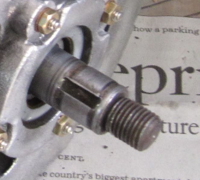

Hello,
It has been a while since the last time I had to replace the generator. My problem is with trying to remove the pulley bolt. Tried using a old style impact wrench with no luck. Just can not figure out how to stop the pulley from rotating. Any suggestions are greatly appreciated.
Thanks,
Steve Bonner
