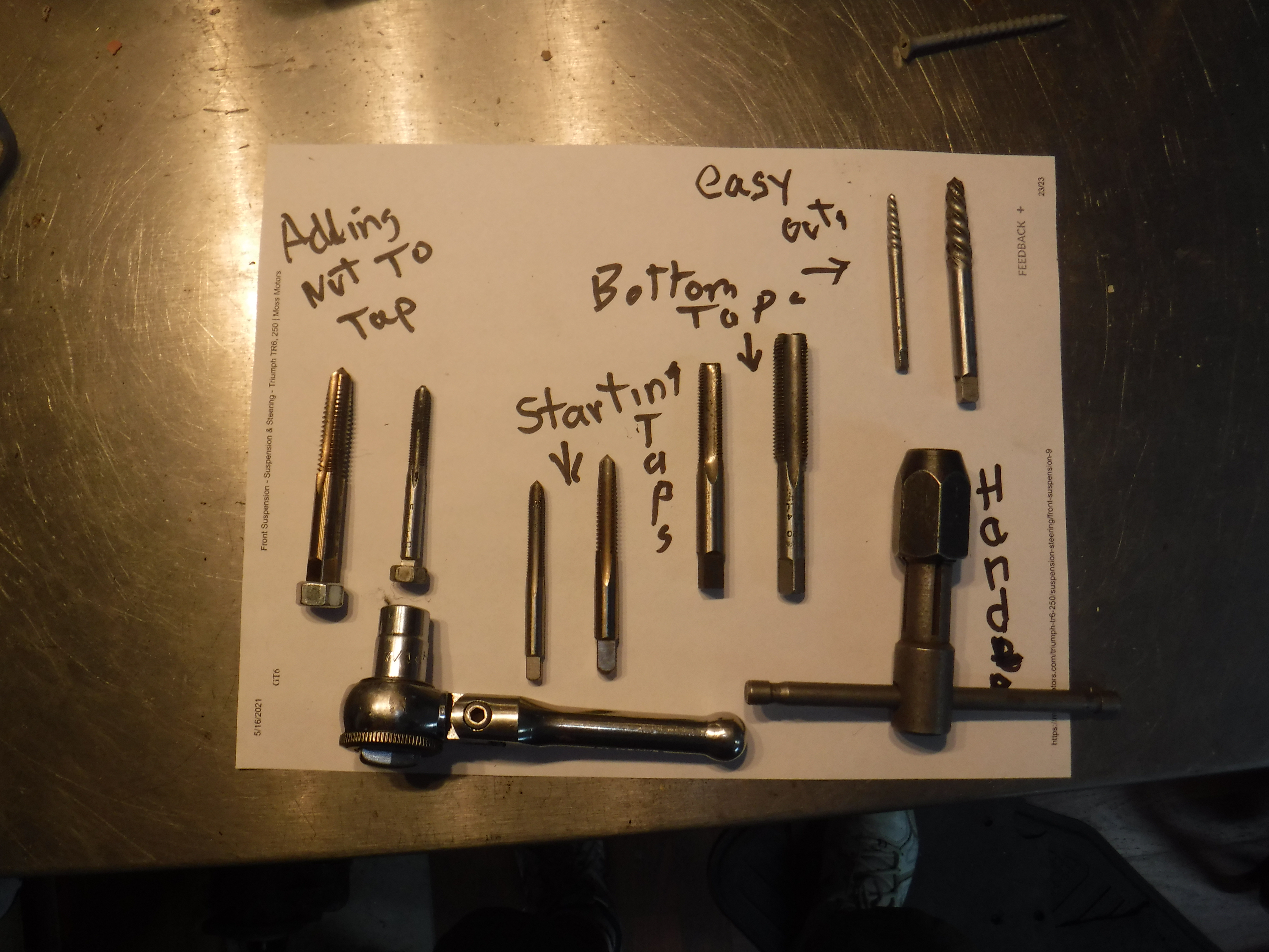

A small set of taps fine thread and a small set of what are called easy outs. A small set of drill bits The taps to chase the threads. Note there three types of taps STARTING RUNNING and BOTTOMING AS for the easy outs They look like a tap that has been twisted . You drill a under size hole in say broken bolt and twist the easy out into the hole CCW this will unscrew the broken bolt . In your case drill out the head of the hinge screw drill a small hole and insert easy out. See pic adding a nut to tap press on with a vice faster than tap handle. The cost of these few tool will help you in your project and pay for them many times over. And some WD 40 to start
