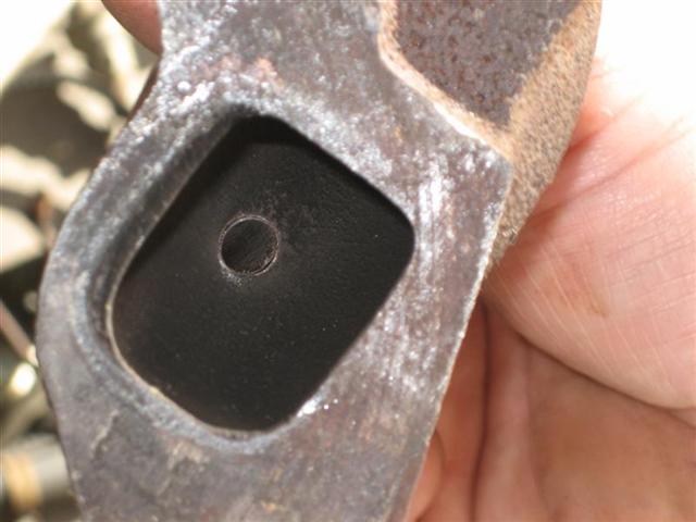

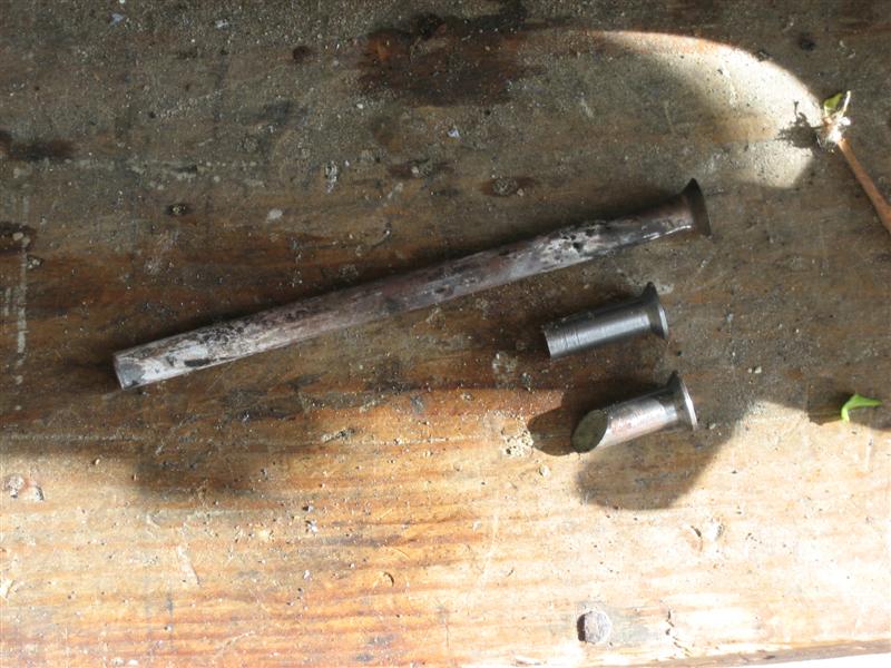

This is what I mentioned above. The long one is one of the original tubes and the shorter two are the solid ones that I had made. The other pic shows how they were fitted.

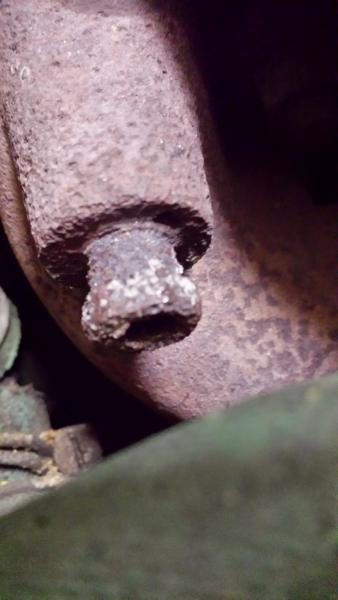

Yeah, I was afraid that it would turn into a puss case. If I had the manifold off the car, I could do a lot of things such as the clever solution Tom created. My immediate problem is that the tube on the #6 port rusted through and blew out. I need to close that exhaust leak until I can get the time to remove the manifold and do it right. Any ideas?
