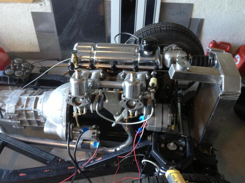

I blasted my exhaust manifold on my MGB and spray painted it with VHT hi Temp ceramic coating. I followed their procedure for heating cycles and it still looks great...very cheap and effective.
Rut
I'm pretty sure this is what we use on the race car exhaust systems and it does hold up well. It's also MUCH more durable than their black ceramic spray paint; that stuff flakes off if you as much as look at it wrong!
