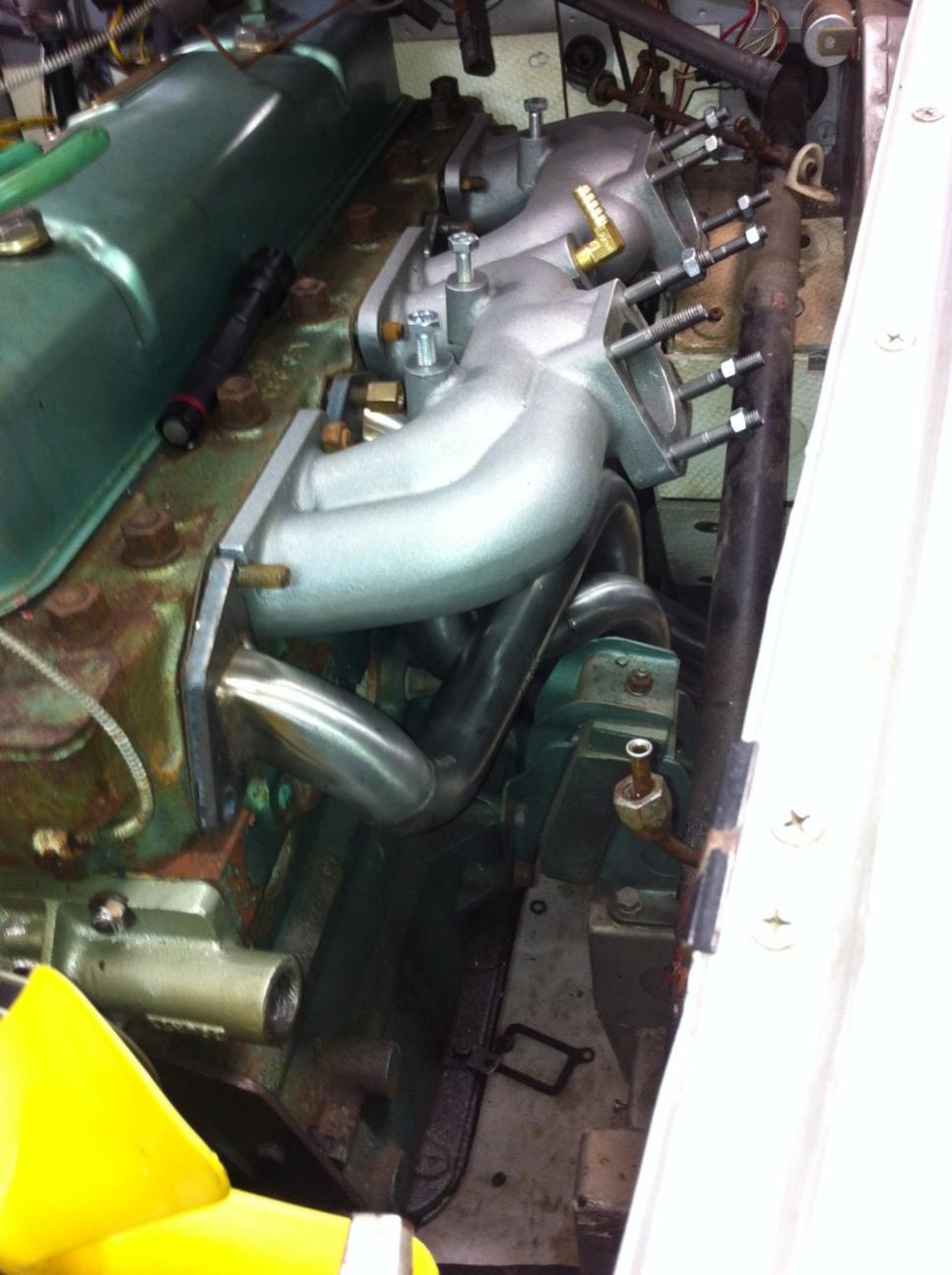

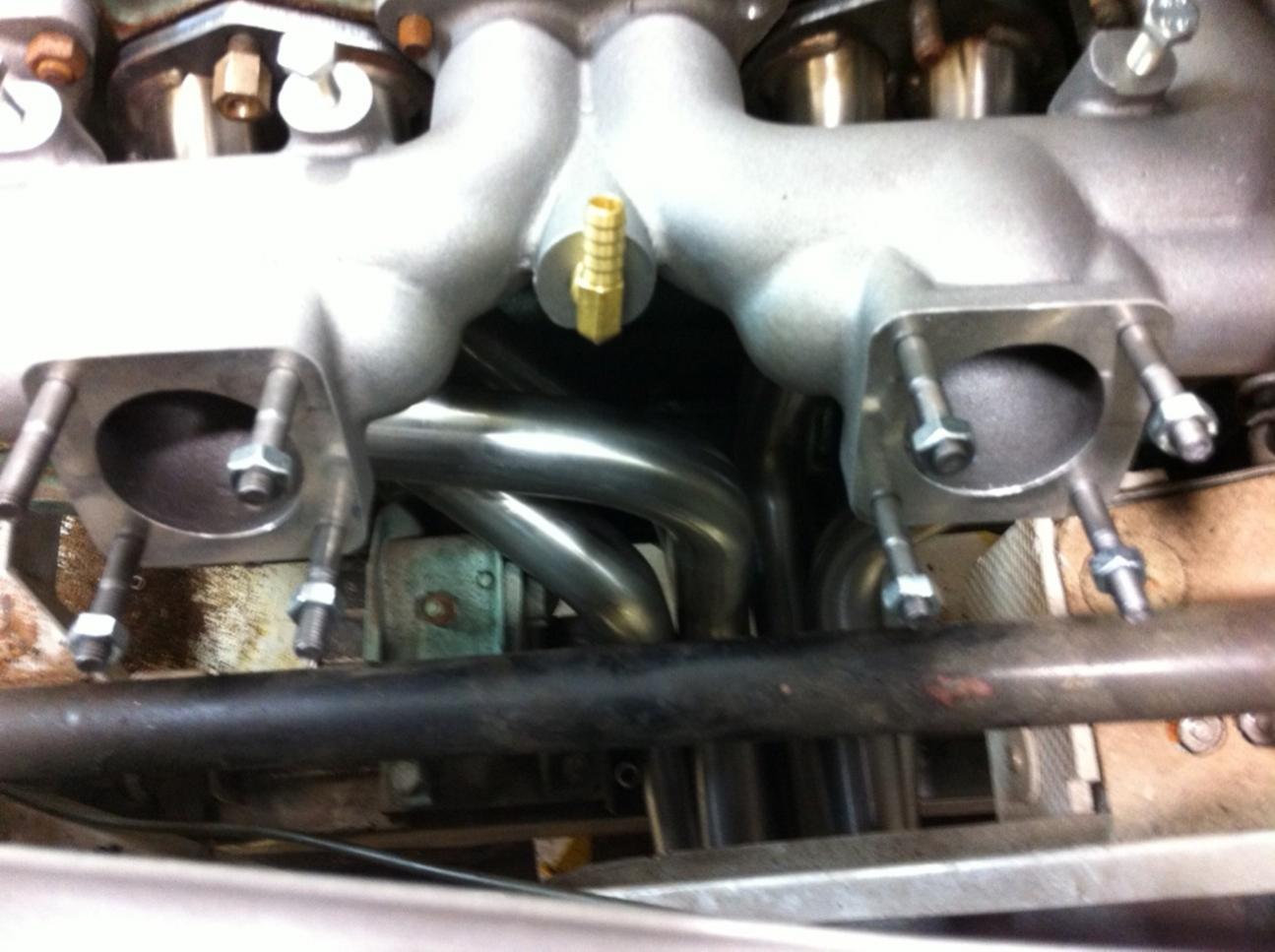

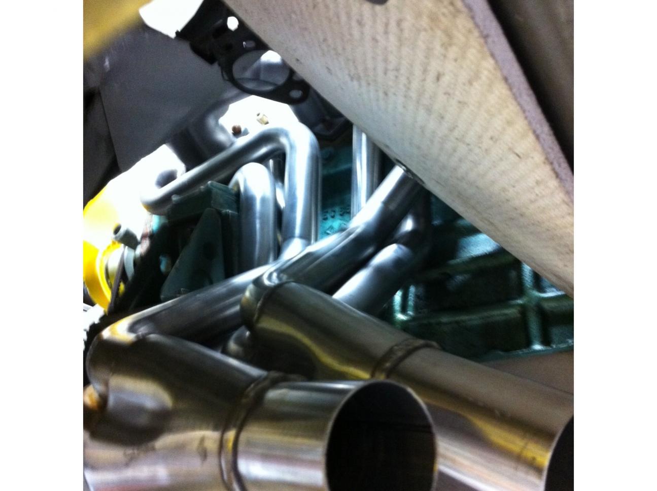

This is just part of the complete rebuild I'm doing on my 1960 3000 Mk1 BN7. While I'm doing all the mechanical, the body will be done by someone else. I should mention that the engine and trans will be coming out to do a total rebuild and smitty conversion. I took the original manifolds, carbs, etc. off to test fit prior to pulling the engine. Remove the manifolds while in the car was fun (not).

Beautiful! I've been looking at that intake for a while but decided to at least finish the car first. I do have those headers though. I had them coated and I wrapped them as well to cut down on cabin heat.

Thanks. I'm planning on wrapping mine too! They are stainless steel. I'm rebuilding a SU HD8 for the intakes. To type everything I'm doing would give me writers fatigue. Looking forward to sending the car off to get the body massaged and painted (above my pay scale).

That appears to be a DMD intake manifold, but I don't recognize the tube exhaust manifold. Is it custom? Steve

No it's not the DMD. I tried for 3 months to get one, but was unable to get a reply from them. I got it from AHspares as I did the headers. With these you don't have to use vertical floats.
