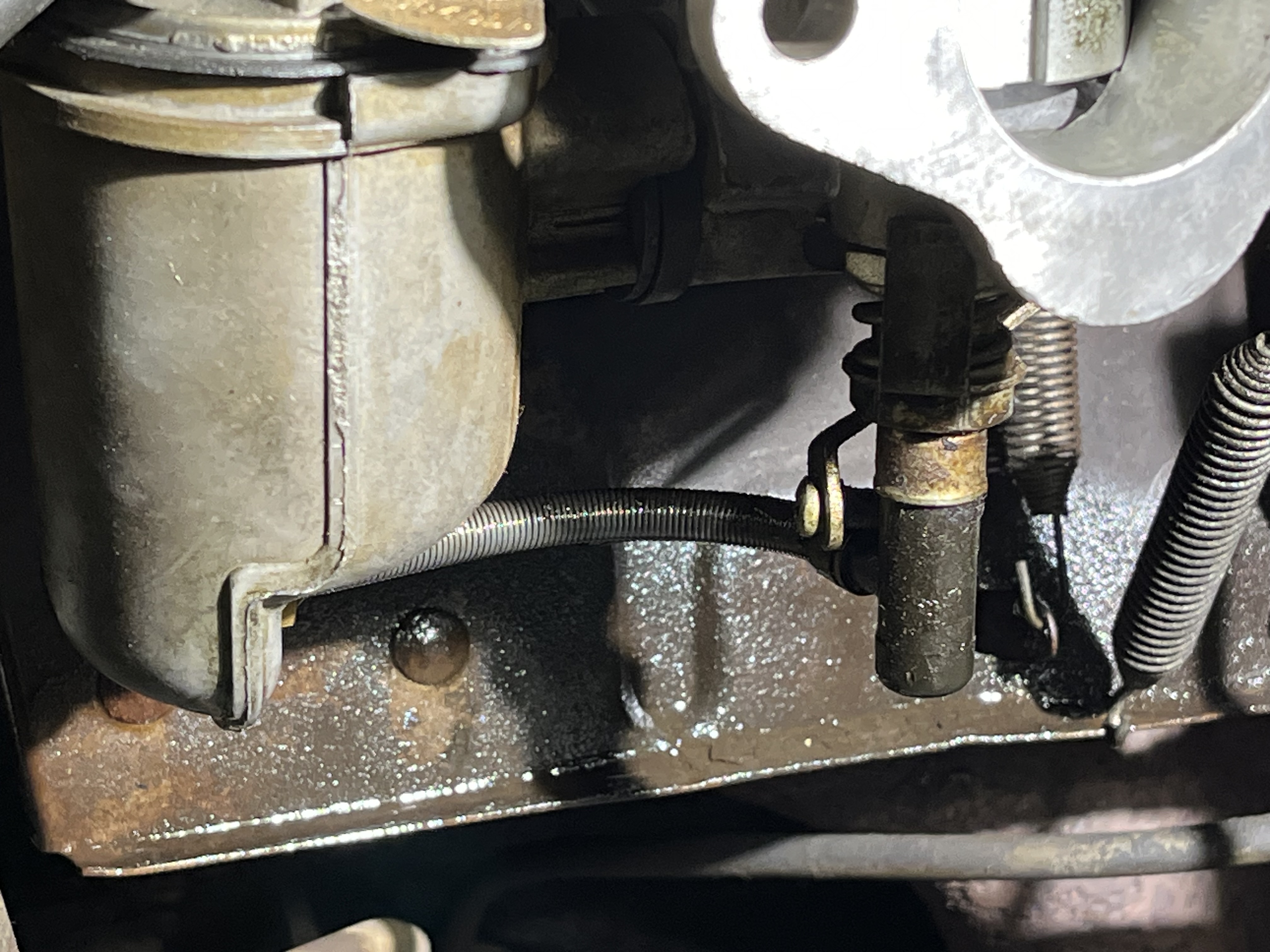

This morning someone spotted a leak at the float chamber and told me how to fix it. The leak is coming from line that leads from the jet tube. I found that the leak is bi-lateral, affecting both float chambers. I've dropped the air intake assembly so I can get to it, but I only made the leak worse by trying to tighten the nut, and my wrench is too big to get in there. I ordered a short 7/16" wrench and new seals for the tube (I suspect they have ethanol damage). My plan is to completely disconnect the tube, replace the seals, and tighten the tube back. I think that's the right procedure. Then I have to put the air filter assembly back on, of course. Wish me luck because I'm not super mechanical. I'm posting to ask if anyone has any tips that I should keep in mind? Thanks!

If that gland nut is on an original SU jet, a 7/16" wrench will be a bit too small. Get a cheap wrench and "skin" a bit off one inside tine. Otherwise you will need a 1/4BS (British Standard, not SAE). And the seal at the bowls can be problematic. Best to get the rebuild kits (I suggest Joe Curto as a source) and replace the seals at a minimum. Digging the old seals out is a job for a sharp pick, BTW. And your leak is likely due to Ethanol in the fuel, the seals finally succumbed.

Yes, it was ethanol poisoning. I've started using ethanol free, but my Dad used ethanol gas. We replaced the seal this afternoon and it's better now. It wasn't an easy job and I don't look forward to replacing the other seal, but it's probably deteriorated, too. Thanks for the advice about the wrench. I did notice that the 7/16" was too tight. I didn't know British wrenches were different!

Glad it is getting sorted - in terms of wrenches there are literally only one or two bolts/nuts on the entire car that SAE - this nut is one. :cheers:

Thanks, everyone. I was so discouraged when the car broke, but it was a thrill to get it working again myself (with some help from my son and a VERY knowledgeable person who was kind enough to text me help and the advice here). Now I have a sticky float needle, so I have to learn to clean that. And the tachometer has become intermittent. This car is definitely a journey.
