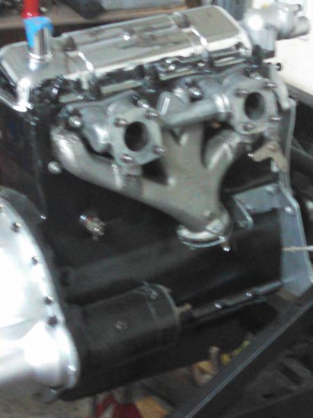

Dash
Sorry it's a little fuzzy but this is what mine looks like after a using a wire wheel on the grinder then spray cleaned with carb cleaner (it's what I already had on hand) then a good rinse. Used rubber gloves to handle after that and sprayed a couple light coats of VHT flame proof primer followed by a couple light coats and one medium coat of VHT flame proof sp998 they call cast iron grey.. had a gas oven in the shed I hooked up a 20 gal propane tank to and cooked it per instructions on the can. Matches the intakes pretty well..will it hold up..who knows...

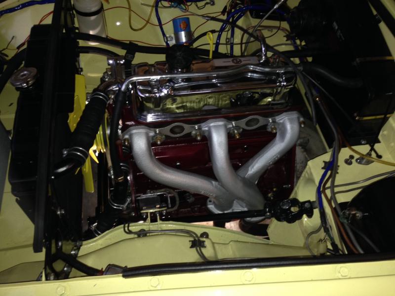

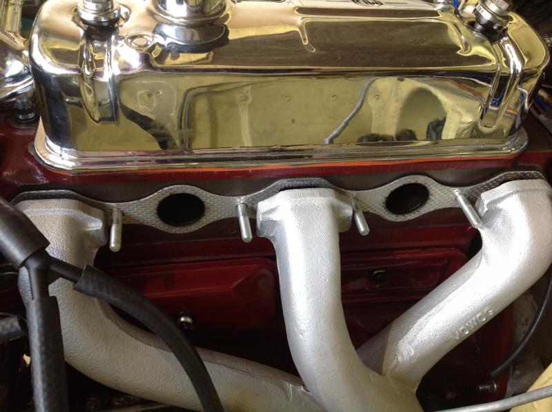

David,
I took a different approach and soaked mine in undiluted SuperClean from Walmart to degrease and remove old paint followed by a soak in Evaporust which removed all the rust. I used VHT cast aluminum ceramic paint and baked it per the directions on the can, but you can just run the engine and get the same result. This one is on my MGB and it's 3 years old and looks the same as when I first painted it.
