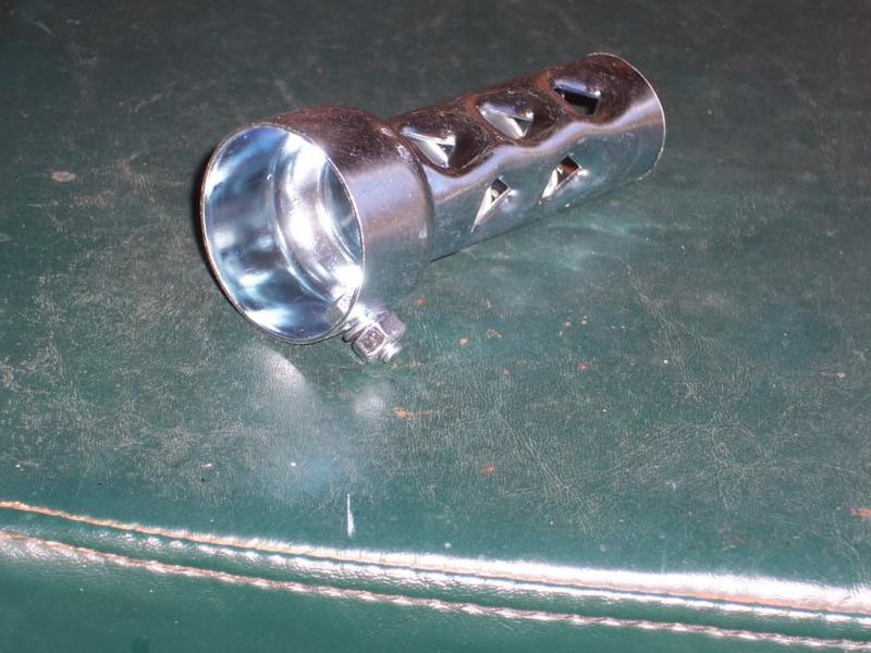

My TR3 had only one muffler (straight thru) and boy was it loud. I added a Monza-type twin tip to it thinking that would help and look nice. It does look nice - still too loud. I found motorcycle exhaust baffles to work great. I bought mine from the Dennis Kirk company. The image below is a $4 special from the folks that sometimes deliver in 3 days. You just need to be able to get to an open pipe area and screw it to the pipe. Mine is at the twin tip connection. My son's TR6 has a twin stainless exhaust with the upswept pipes in the back - sounds and looks sweet.
Good luck.

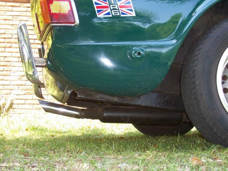

My 74 TR6 had cherry bomb type glass packs when I bought it.
Cormae could hear me coming when I turned off the highway onto our road one mile away.
Remembering from when I rode a bike, what baffles do to keep from getting a straight pipes ticket I made some for the TR6.
After that I could get within 1/2 mile of the house before she heard me. BTW, I think the added back pressure increased the torque a bit, too
After I posted, I remembered that I removed the homemade baffles and went with these that I found on ebay:

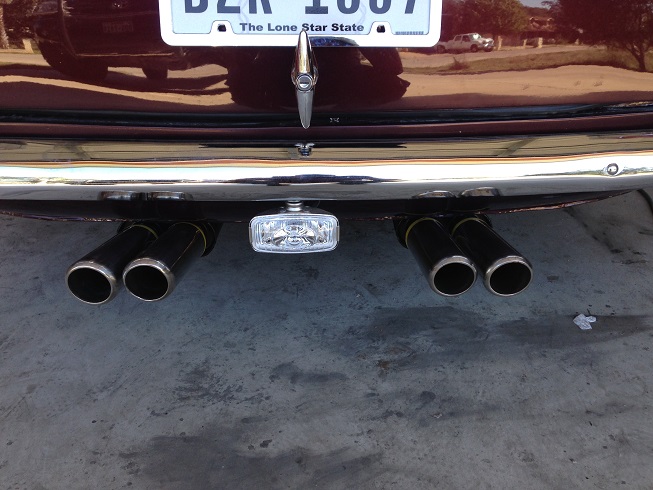

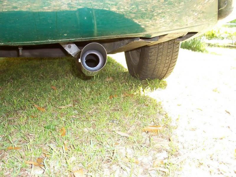

There are lots of options out there, I've usually opted to go to a muffler shop that uses stainless tubing and had a exhaust system made. You can use a larger diameter pipe than stock and use Flowmaster/Magnafow mufflers (with lots of noise options). I started with Pacesetter/Monza twin mufflers, but, they were too loud and they hurt horsepower when the car was on the dyno. I'm currently running stainless tubing with a Magnaflow muffler and a single pipe in 2.5 inch diameter with a twin resonator tip. You won't need 2.5 inch diameter unless your running a lot more horsepower.
