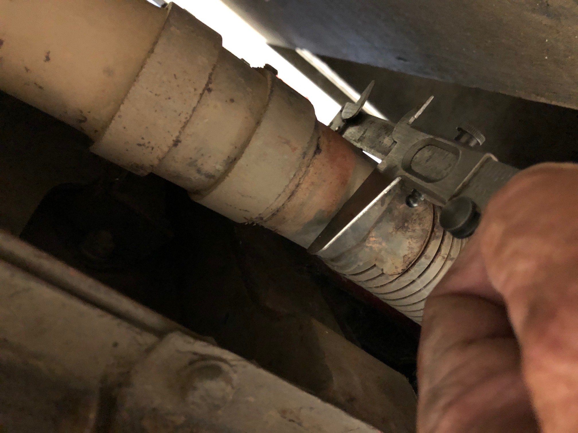

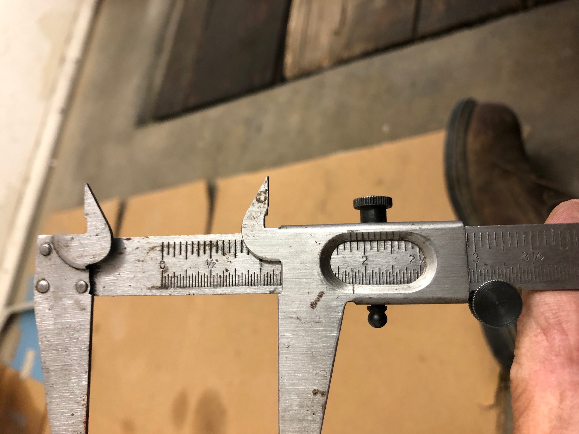

1 & 7/8"

I have 2 AP exhaust glasspacks on it now but they are 2 in. I.D. and a 1 & 7/8"
Down pipe ???????
Dunno what to tell ya, K. Those are stock downpipes, probably nominally 1 & 3/4" ID, with 1/16" thick tube walls. Pipes with 1 & 7/8" ID would likely be 2" OD.
