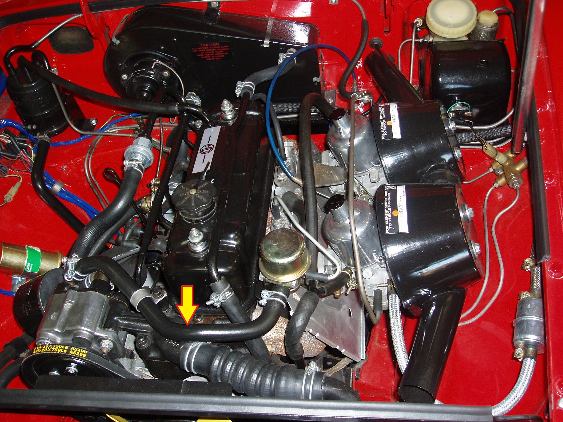

If you have this original hose in the system, I'd be very reluctant to throw it away! Near impossible to find as they haven't made them in years, and are needed for a concurs restoration. PJ
