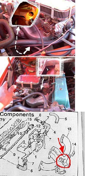

I’ve got a 79 Midget (1500 engine). It’s got the Weber carb on it. It had been running fine but apparently has lost a plug that was in a hole in the exhaust manifold. Most likely part of the emissions equipment that's no longer there.
The hole is about 3/8 in round and the 3/8 NPT plug doesn’t fit. The threading in the hole seems to be thinner than the 3/8 NPT plug from the hardware store. It’s in an awkward place, which has made it more difficult because if I drive somewhere to have someone take a look at it it’s too hot to even see, much less touch.
I’m hoping that someone can tell me what was in it so I could have a reference point in my search to plug it. I’d even be happy with a suggestion as to what material could plug it and withstand the heat. As you could imagine, it sounds like a small tank!
It’s been sitting for a while, I’m out of ideas.
Oh yeah, the best I can offer is a crappy pic I took and a diagram from a catalog showing where the hole is approximately.
Mario

Hi Mario, I'm pretty sure that's where the EGR valve went. Earlier ones had it up on top between the intake manifold and the valve cover, but it seems to me it got moved to that location on later ones from pictures of other 1500s I've seen. I've heard of some folks just finding a bolt the right size to plug the EGR hole with, but I couldn't tell you what size that is.

I agree with Dave. That is where the EGR valve is on my '76. It isn't functional and I plan to remove it when I do my engine rebuild this winter. When you determine what will fit in there let us know. I had just considered welding mine up if I couldn't find a plug for it.

Thanks to one and all. Once I figure out what size/type of threading it is, I'll let you know. Since the NPT (National Pipe Thread) wouldn't fit I'm trying to find a metric plumbing plug but haven't had any luck thus far. After that, I'm not sure which direction to go.
