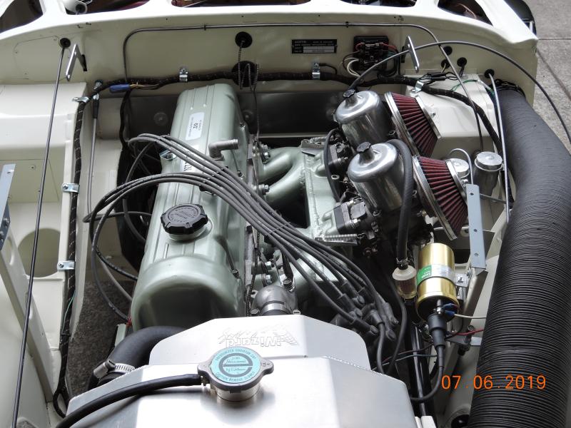

My Nasty Boy is a bit different. A Nissan motor and 5 speed out of a Datsun 280Z. 170 Hp and 200+ pounds lighter. No cutting of footwells or chassis. Motor mounts line up with Healey chassis mounts. Oil pressure capillary tube screws into Nissan thermostat housing - same threads. Uses stock Healey exahaust system from headers on back. Sounds like a Healey. Paint it Healey green and use SU HD8 carbs. Goes like ****.

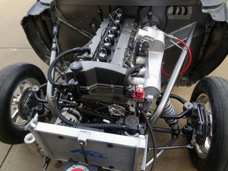

Richard's right. There's a lot of other options besides a V8 and if you go inline 6 you don't have to do the body mods. David Pfaff has used a Chevy Vortec 4200 Atlas motor. Here's the specs:
[FONT=&quot]The 4.2-liter Atlas LL8, otherwise called the Vortec 4200, was a groundbreaking engine for GM. It featured an all-aluminum construction, dual overhead cams with variable valve timing on the exhaust side, four valves per cylinder, a coil-on-plug ignition system, a high compression ratio of 10:1, and its cylinder heads featured GMā€™s then-prevalent ā€œVortecā€ engineering designed to maximize airflow.[/FONT]
[FONT=&quot]This combination allowed for the production of 1.06 horsepower per cubic inch ā€“ a total of 270 horsepower at 6,000 rpm. Torque was rated at 275 pound-feet at 3,600 rpm, but 90 percent of peak torque was available between 1,600 and 5,600 rpm.

Are there any pictures of the Pfaff installation?
BoyRacer
I did a Google search and this is what it looks like. Ugggh. I wouldn't want to see this in a Healey. Just my 2 cents.

Don't know if Reid was in CONUS during the great Roger Moment v. Mark Lambert wars where the originality vs. engine swap battles were fought. Mark originated the 280Z swap and I even found Richard Mayor's reference to Mark as giving him the idea: https://www.ahexp.com/forum/healeys-list-archive.13/280z-motor-in-a-3000.77331/

What kind of car is the pic above with the Vortec engine?
That's in a Vega. The last year of manufacture for the Vortec 4200 was 2009 so finding one in a Pick-n-pull would probably need a rebuild. It will mount to a Camaro 5 speed. The engine, is all aluminum, weighs in at 480 lbs, so you're saving some weight over the Healey motor at 611 pounds. If there wasn't a need to fabricate a new intake, I think it would be a pretty good swap and it sure made David's car move. He runs it trough Healey mufflers and it even sounds Healey-like.
