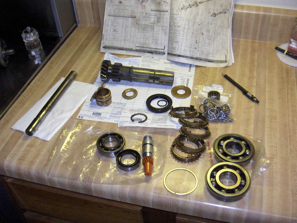

In June 2006, I rebuilt my TR6 transmission, (no overdrive) but including a clutch and doing all the work myself, I spent at least $475 on parts. -including a great deal on a "parts" transmission because I needed a new 1st gear w/countershaft assembly. (The clutch was $180.)

If it really is an OD trans, that's a score. I rebuilt a junk trans over the summer and replaced the exact same parts as TexasK-head except for the speedo assy. The TRF gearbox rebuild kit is a good starting point. Count on using new countershaft thrust washers; I needed a tophat bush, which is not in their kit. Cost was about $350 for parts.
I got lucky and found a local shop with a good TR6 laygear mixed in with their MG gears. I used an early press-in type countershaft bearing at the rear because it has more needle bearings in it. It was a cave-man kind of rebuild with no real special tools, but I had nothing to loose. Time will tell, with 2200 miles done so far.

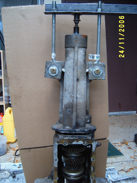

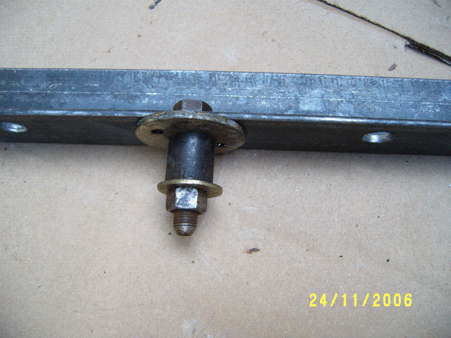

Other than a copper knockoff hammer, wood and some drifts to tap bearings on & off, the only special tool used was this rear extension puller I built:
Of course, you don't need it to remove the OD unit from the main box.
Jeff
