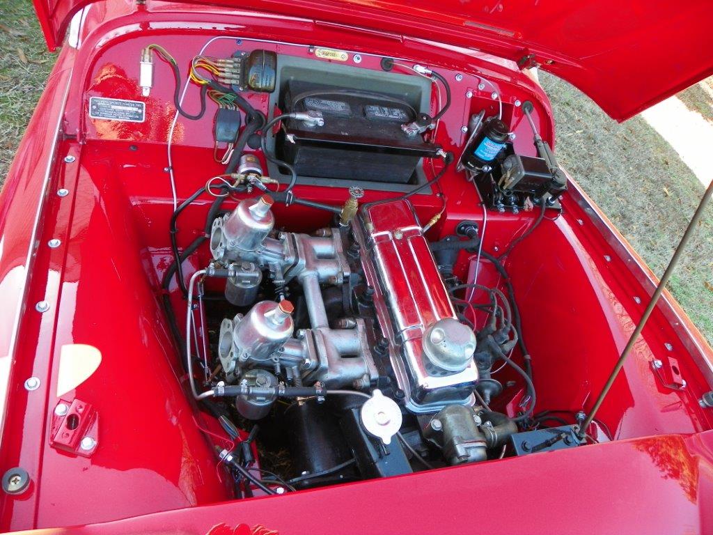

This shot gives a nice view of the paint on the 72. This was professionally done, not by me! It's single stage, clear coated. PJ

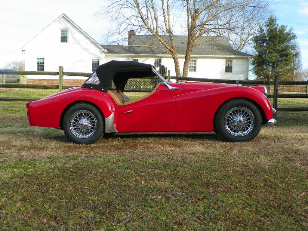

Pic of the current car I am building with S/W paint. Bob

That's a beautiful paint job Paul. My opinion is that clear coat is not needed on a solid color that is not used for everyday transportation. It's not unusual to see the clear start to fail and cause spots. Manufacturers use it to cut cost on the expensive pigmented paint. They can use very little color and add clear for gloss and durability. The clear is starting to fail in a few spots on my '04 Cooper. Mainly on the plastic parts. Here is a B-GT I painted several years ago. The paint is 18 years old in this photo.
Steve, I agree with not clear coating these cars, but it was in the shop and done before I could catch it. Most of these cars are so pampered, the clear coat is not necessary, actually, it makes repairs much more difficult. My TF will not get clear coated. PJ
