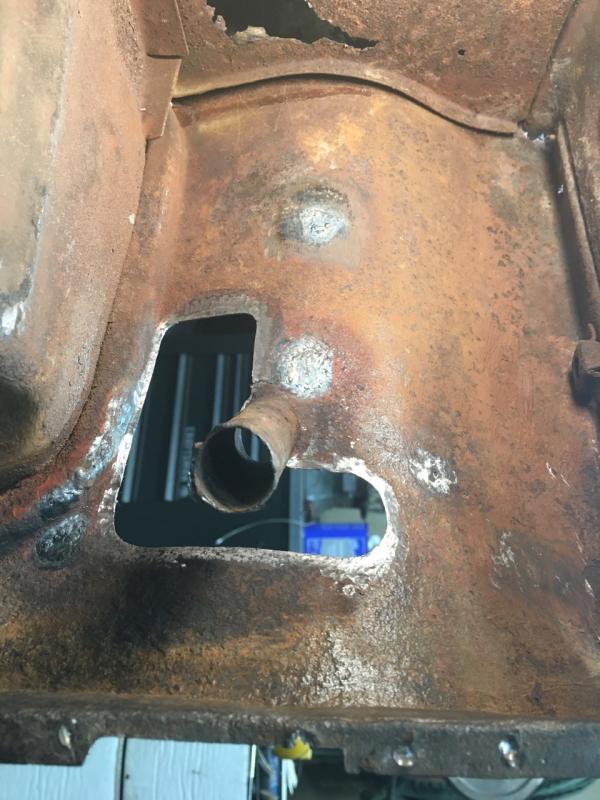

Since the subject has come up I can use some advice. I will be sandblasting the inside of the rear lower part of the valance. I have removed the vertical closing panel and fabricated a new one to be installed after the inside is sandblasted and primed. My under standing is epoxy primer is a sealer to prevent moisture getting to the metal and starting to rust all over again.After this area is primed it will not be seen again. My main objective is stopping any further rust that might cause a problem down the road to the final paint job. I have looked at SPI direct to metal primer, I am also looking at Tamco, they have 2 different primers that are interesting. I have seen mixed reviews on POR 15. I have plenty of the POR 25, the other two brands are roughly $100 a quart. one of the Tamco primers is direct out of the can the other mixes 1:1 yielding 1/2 gallon the same with the SPI primer. What is being used in this area? Thank you for your input, Frank
inside rear valance driver side.jpgThis is the area I am referring to driver and passenger side as well as below spare tire and inside of the closing panels.

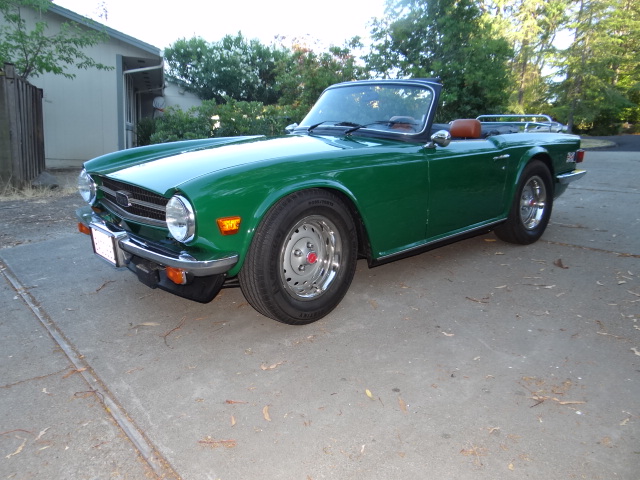

I used Tamco products on my TR6 restore and was very happy with the result. I followed all the steps as I learned in my body shop JC class. I used a two part color and clear.DSC05961.JPG Scott in CA
